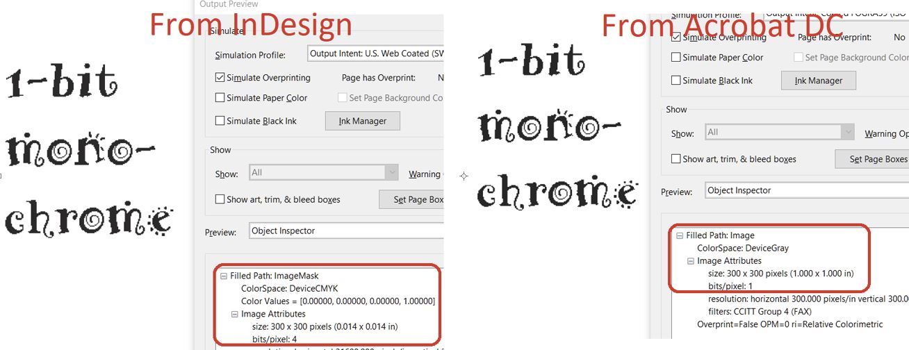

It seems like InDesign is reformatting my images when I don't want it to, during PDF export.
I have a simple InDesign document. I place an 8-bit grayscale TIF file, and a monochrome (B&W) TIF file on a single page.
I export this to a [PDF/X-1a:2001] file, with the following change:
Output - Color - Color Conversion = No Color Conversion
I then open the exported file with Acrobat DC, and select Tools / Export / Image / TIFF ( Export All Images )
Using Photoshop CC, I open the two TIF files that were exported.
The 8-bit grayscale image is still an 8-bit grayscale image.
However, the monochrome image is now a CMYK image.
Since InDesign's Export feature specifically contains Compression options for Monochrome images, why am I getting a CMYK in exported out of the generated PDF file?
Or most importantly, how can I export my InDesign file so that I'm sure the monochrome image remains monochrome (1-bit B&W) in the PDF it creates?

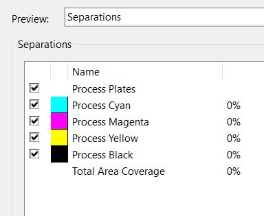

I did as Danny suggested, and in the preview neither of the two images reports anything but a 'K' value, with C,M, and Y all zero.

I don't believe I've done that. With InDesign, I created a new document, Place the 1-bit image on a page, Place the grayscale image, and then Export it. And when I look at it in Acrobat Output Preview, it doesn't show any extra colors in 'Seperations', just C,M,Y, and K.
So I'm not sure why the printer mentioned "1-bit spot color monotone images", if all that shows in Print Production - Output Preview.

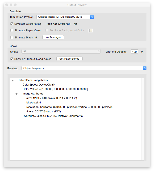

Does this explain why I am getting a 4-bit image in my PDF when I started with a 1-bit image? I reset everything back to PDF/X1a defaults and did an export of just the 1-bit image, and the OutputPreview in Acrobat shows it as a 4-bit image. If I use Acrobat DC to create a new PDF file, then place the same monochrome TIF file in it and save it as PDF/X1a, when I inspect that PDF file it contains a 1-bit image.

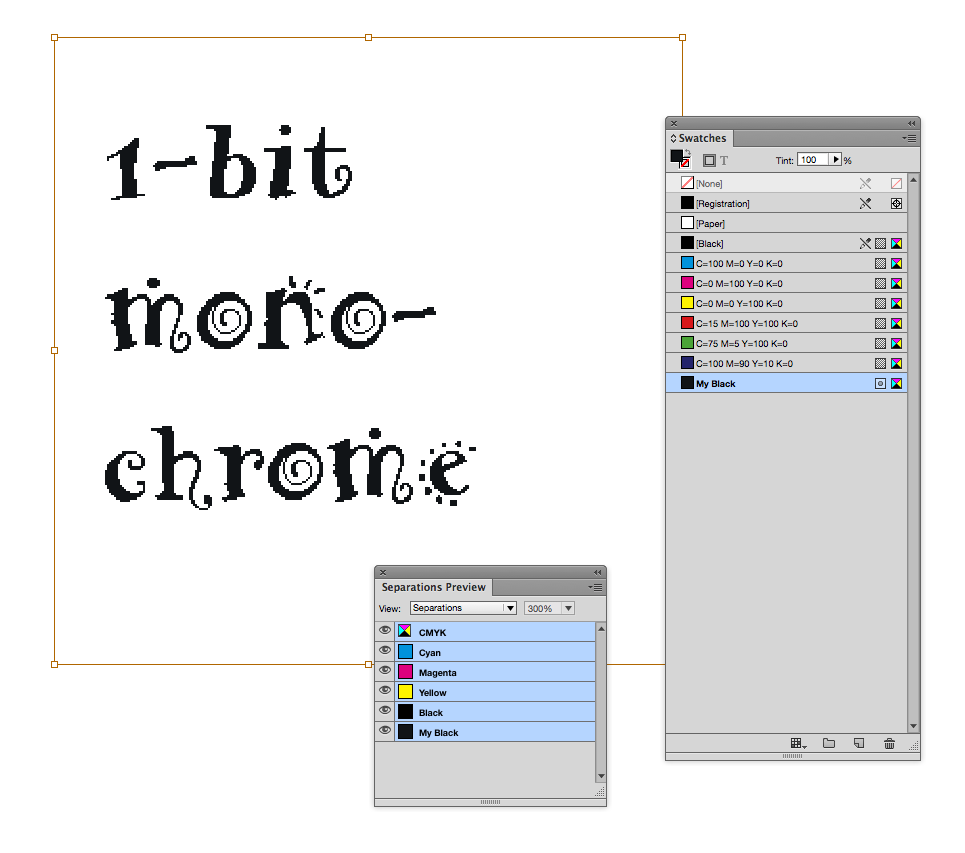

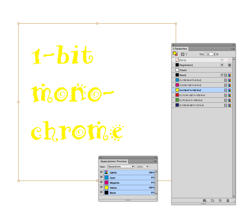

Also, the bits per pixel is not relevant in your case because there are no gray levels (other than black and white) in your placed image. InDesign lets you assign different colors to the white and black pixels, but you've left the image at the default [Black]. With an PDF/X-1a export the black pixels have no where to go other than the Black plate, which all of your PDF's are showing.
You could assign different colors on purpose or accidentally, that's why it would be helpful to see the PDF the printer is rejecting, or at least a capture of the Swatches panel of the job's InDesign document.
These wouldn't cause a preflight problem:
But this would:

What I still find odd is how the printer indicated "1 bit spot color monotone images" when the images do not appear as a spot color (I expected), or even 1-bit monotone (I expected, but my PDFs indicate 4-bit).
I think the extra bits coming out of InDesign are there so the image can act as a mask and have any color applied, which is an important ID feature, but doesn't affect output quality. The printer might also be flagging the resolution of your 1-bit images—typically 1-bit images filled with black (line art) need more resolution. The line art with text in your example would need 1000+ ppi to be accurately resolved.

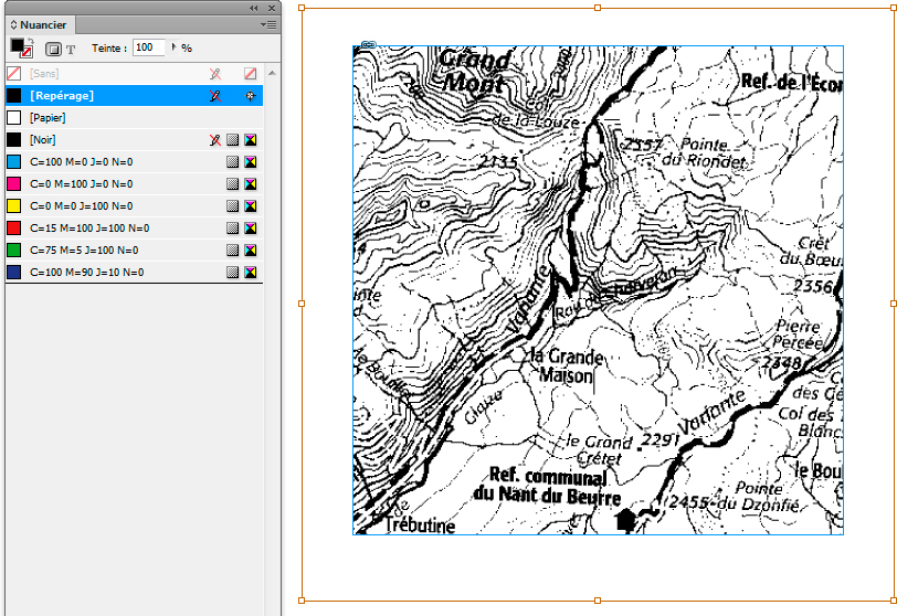

Now, is there any chance you applied a color to your bitmap image?
See example below: I "accidentally" selected the image using direct selection tool and applied "Registration".
Looks black but obviously if I check my PDF, my black is in fact 100/100/100/100...
You might want to check that too...
When you place a 1-bit image the monochrome pixels always get assigned a color, which is by default the CMYK [Black] swatch. If you direct select the image you can assign any CMYK, RGB, Lab, or Spot color.
If you export the page with No Color Conversion Acrobat defines the 1-bit image as an ImageMask filled with whatever Color Space and Color Values you chose over in ID. You can use AcrobatPro's Output Preview>Preview>Object Inspector to see the image info. The Separation preview only tells you how the image's color will output given the chosen Simulation profile, and not anything about the image itself.

And here's the same image with a 100|0|100|0 CMYK fill
