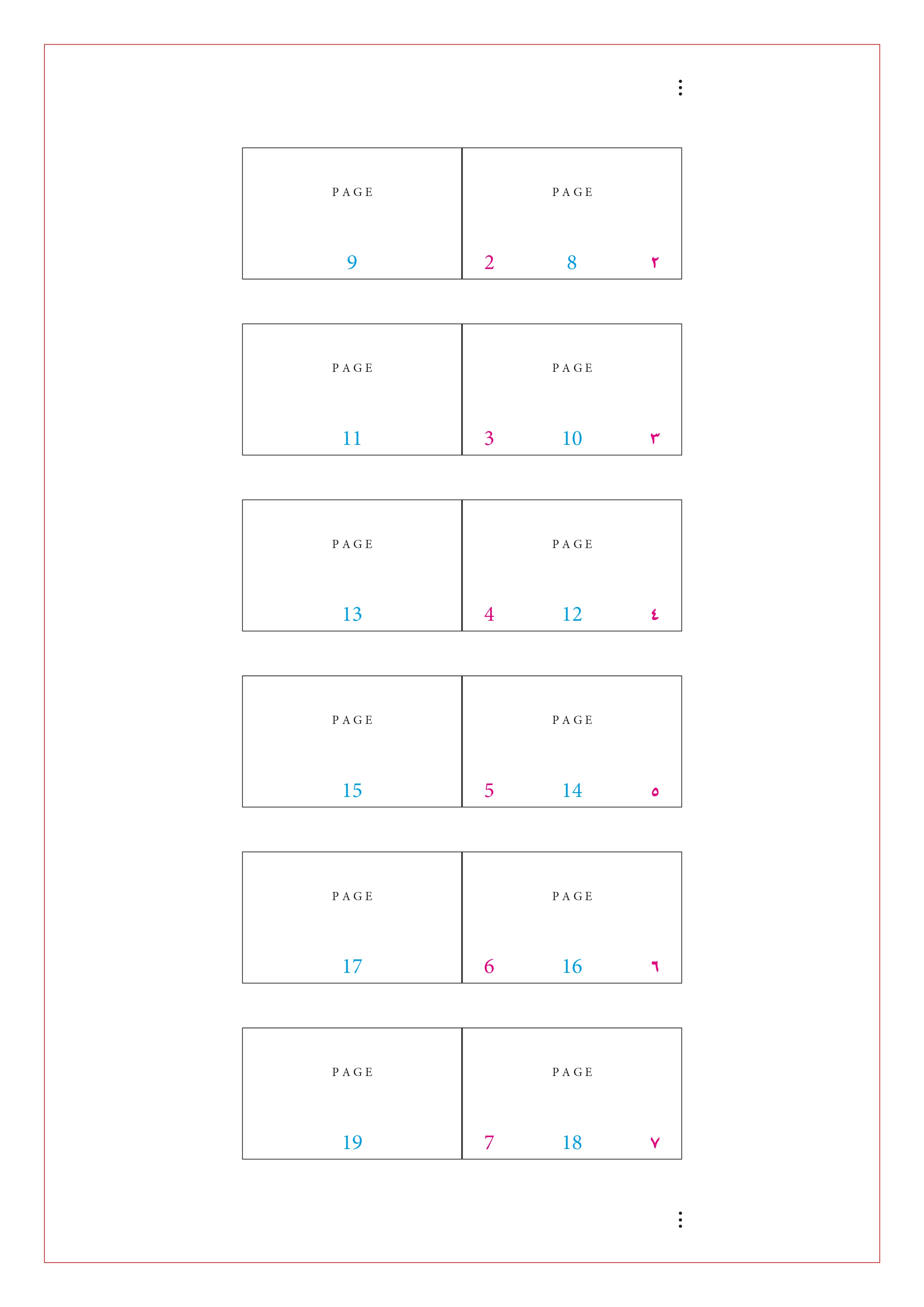

Hi, friends..
There are 1200 pages of design documentation. There is automatic pagination in the center at the bottom of the pages.
Also, starting from the 8th page, how can I make Arabic page numbering starting from 2, at the bottom and right of the pages automatically?
In the same way, starting from the 8th page, automatic numbering will be added to the bottom left of the pages, again starting from 2.
This system will reset and repeat after page 620.
Thank you so much in advance for your valuable help.
iMac 2020 Sonoma, InDesign 19.0.1
like this one here:

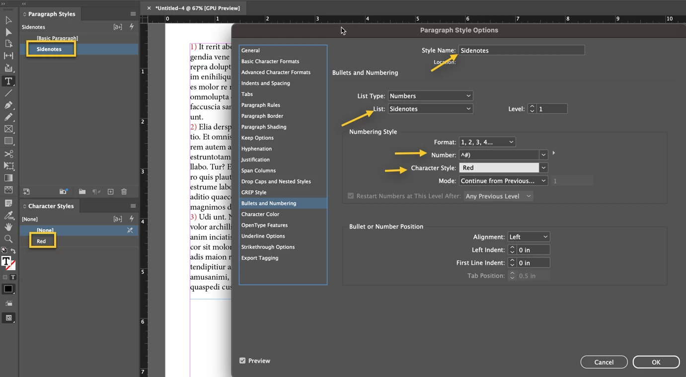

Hi @Rba Mrym:
I looked at your file and it is indeed complex. As a heads up, you will be able to number the sidenotes with autonumbers too, including the red color and the close parentheses. To make sure you don't lose your mind, please read up on styles: paragraph and character styles. You will need both. InDesign can handle multiple numbered lists (I know of three you need so far) as long as you name each list.
For example:

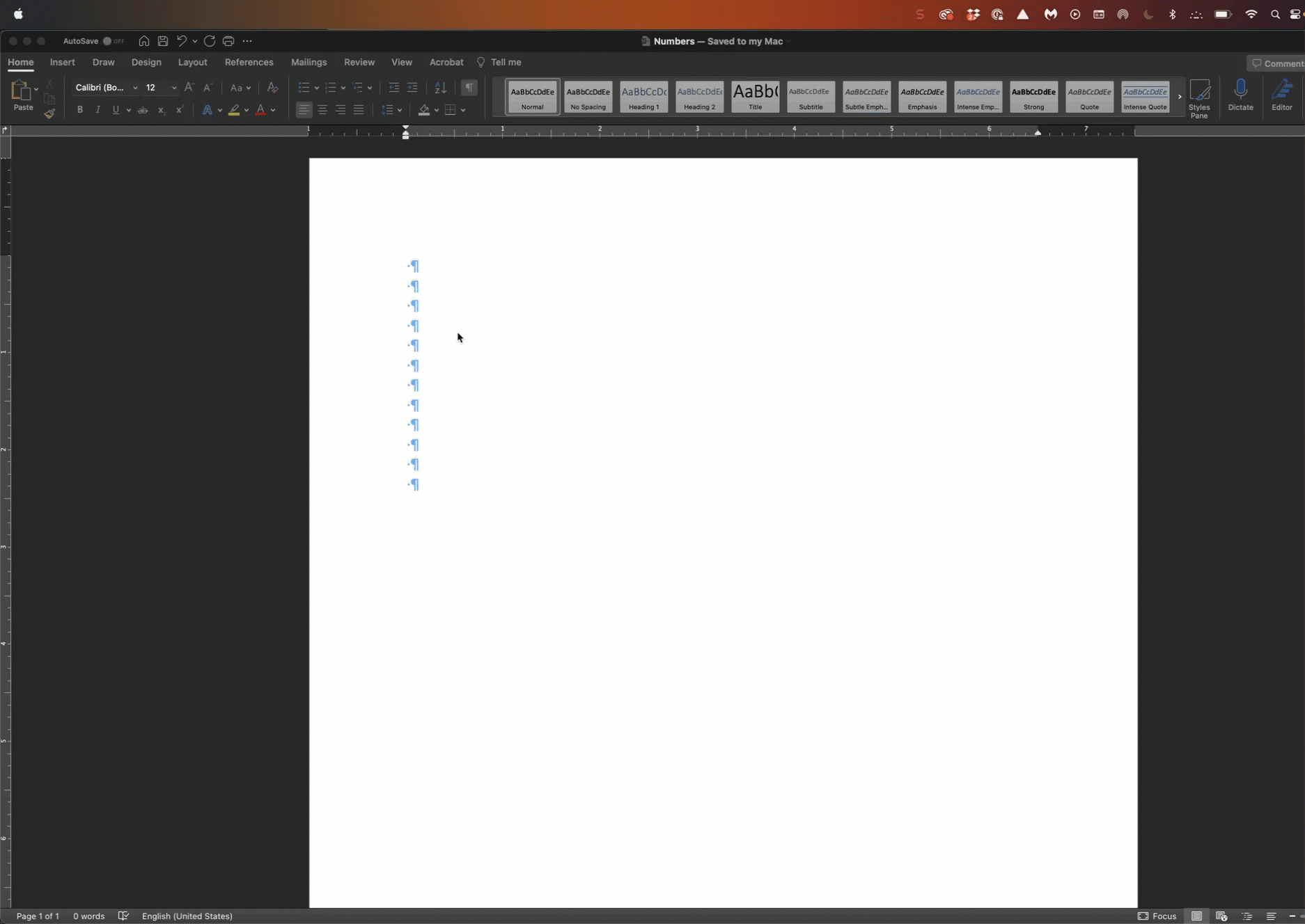

My video clips are fast because we are limited by file size, which ends up translating to about 30 seconds. Anything longer won't load. On the bright side, you can watch them as many times as you like until you figure it out!
Don't worry too much about the Office integration. The video started in Word, where I made a list of:
space ¶
space ¶
space ¶
You will need one for each number, so copy/paste is your friend. Then I saved the Word doc, used File > Place to import it into InDesign, and hovered over the frame visible to the left of the blue number. (I drew that frame and the one to the right of the blue number on the right parent page.) Shift+click will autoflow the list, filling one frame and then moving on the next. Finally, I selected the entire list, assigned a paragraph style with a type size that was large enough to fill the frame and the numbers populated the rest of the document. Remember, each autonumbered list needs a unique name (enter it to the right of the word List in my screen shot above).
Best of luck!
~Barb

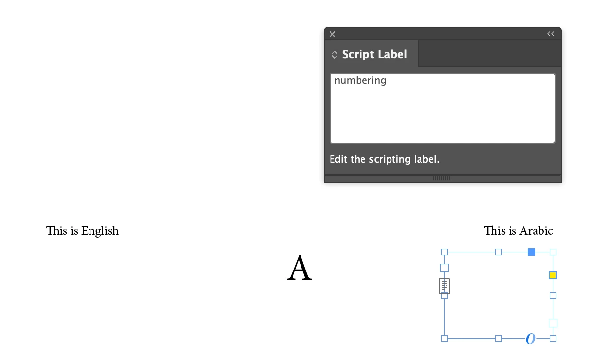

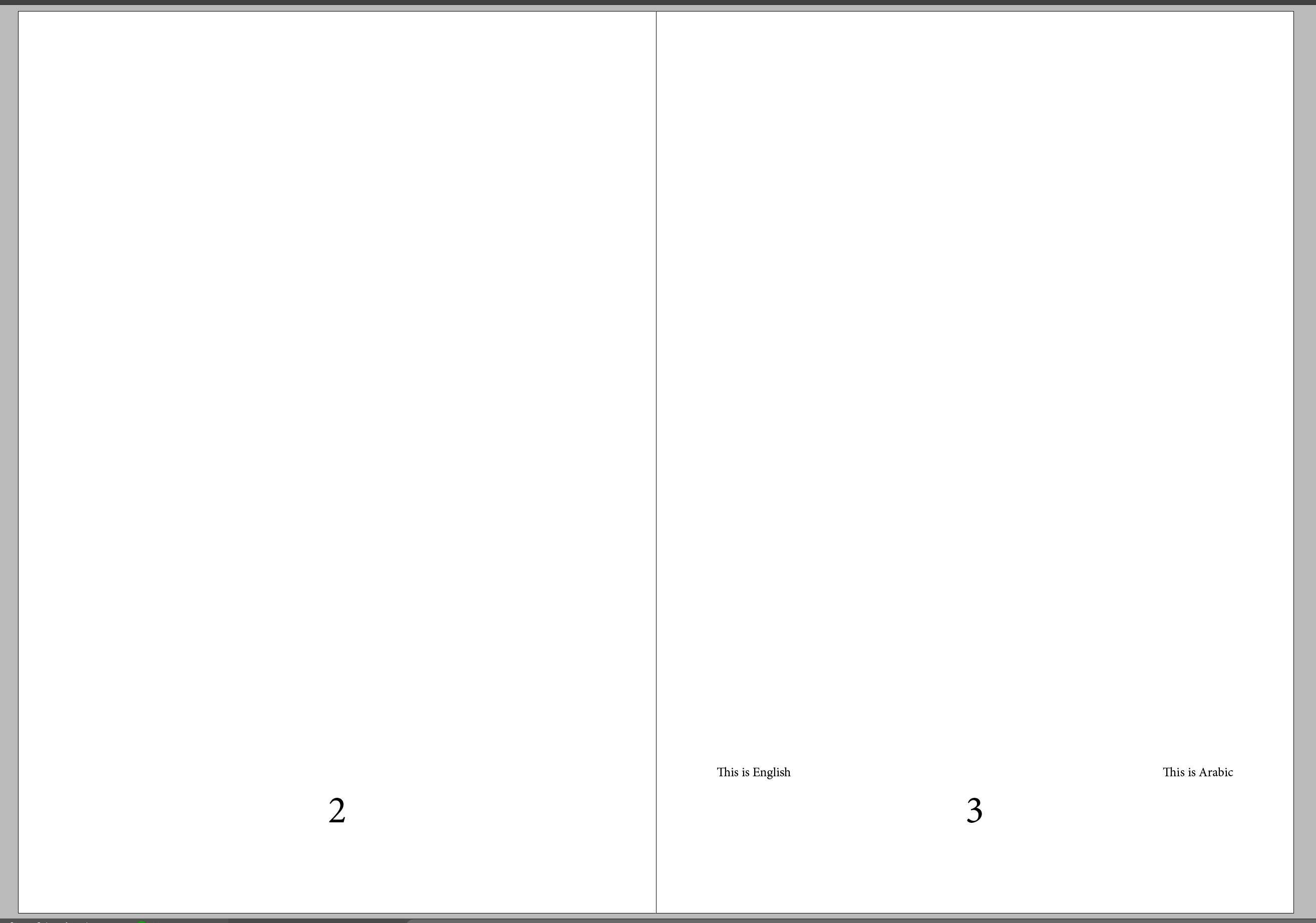

Hi @Rba Mrym, you've got two correct answers already, but I was thinking about it after looking at your complex document and I think you are right—that a script would be ideal because it would keep your document as simple as possible.
I've made a demo file (attached) that shows a basic set up using master page text frames for the numbering and script labels (very important because that's how the script knows which boxes to number). You can see in the screen shot below I've used the label "numbering":
The text frames have object styles linked to paragraph styles. I don't have the ME version of Indesign and I could get the Arabic numerals to set properly via ExtendScript. Let me know if it doesn't work in your version either and I'll explore further.
Here is the script I wrote. Let me know if you decide to give it a try.
- Mark

P.S. Your little pagination mockup on your first post showed page numbers on the right hand page of a spread, but your demo document didn't look like that. Anyway, hopefully you can get the idea. Note that the script includes the part where it resets counter at page 620.
Edit 2024-01-05: minor edit to script documentation.

Hi @Rba Mrym:
InDesign's page number marker is limited to the actual page number, so use that for the blue, centered, incrementing numbers.
You could use auto-numbered lists for the other two (or use Excel to type the actual numbers) and then auto-flow them on the body pages into a frame drawn on the parent page.
In my demo, I added a series of space/returns in Word, placed them into the first frame on page 2, and assigned a paragraph style that addes the autonumber, and fits one number per frame. (I added the space in front of the returns because auto-numbers do not show up unless there is some content on the line.)
Something like this:

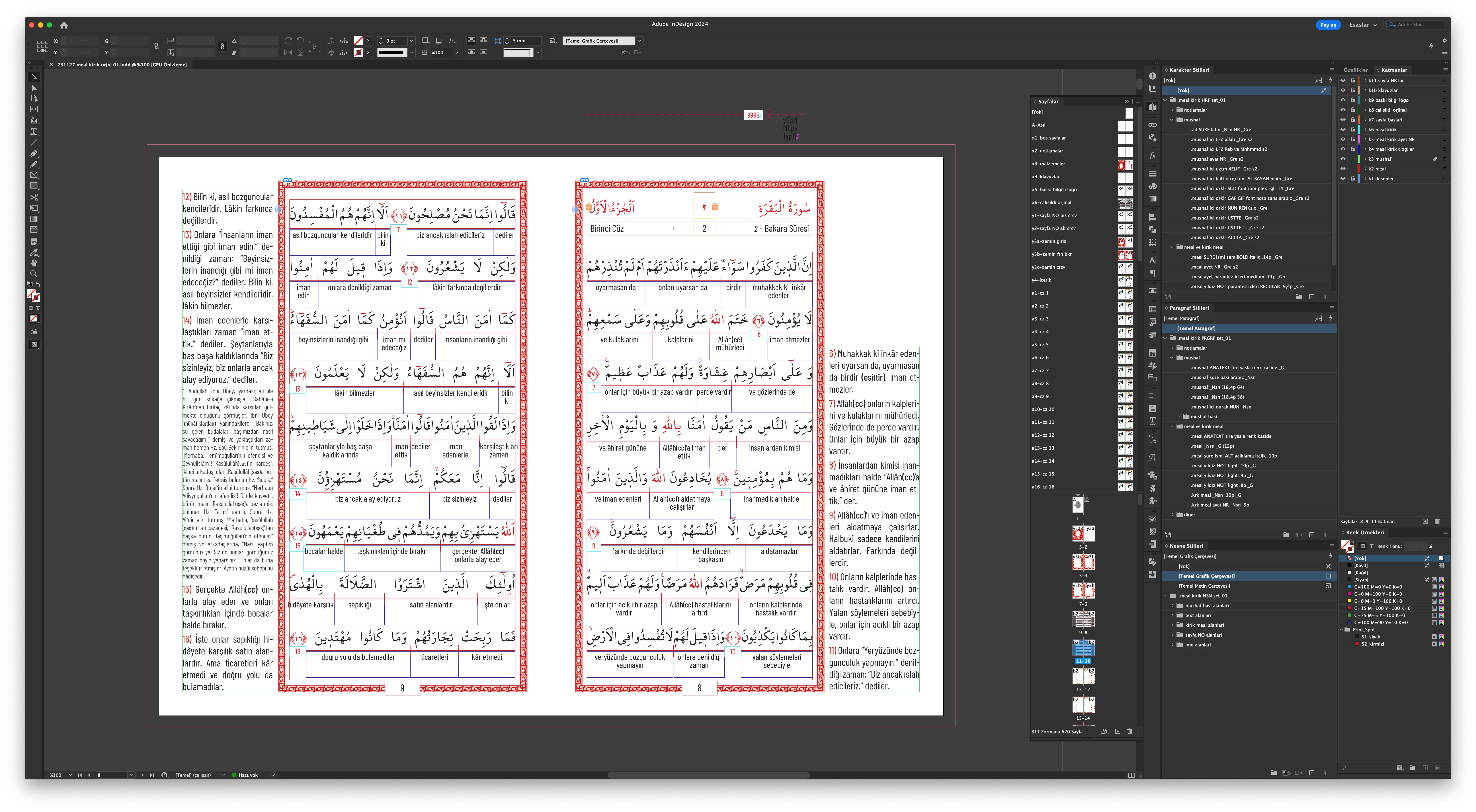

Yes, I'm new here, I'm intermediate in indesign, but I'm preparing a very complex book with more than 100 master pages, I think I'm going to sweat a little.
Obviously, your demo is a bit fast and I had a hard time following it, but I still think I can reach the conclusion by surfing YouTube based on the main words in your explanations (auto-numbered lists, auto-flow, etc.).
Unfortunately, I have no experience working with integrating office applications, especially in Indesign. Of course, if you want to prepare a tutorial with narration, you can be sure that I will watch it with admiration. 😉
Actually I need so much help because it's a very complex design with dozens of interconnected chapters and sections and different numbering. I'm attaching a small part of it as a pdf if you want to look at it.
PDF file is here:  https://we.tl/t-mkOahBncfF
