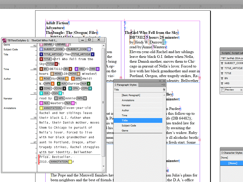

Hi, I've been working on this project for sometime and everytime I manage to get one part of the workflow to work another seems to break. My agency publishes catalogs in multiple formats: large-print, audio, braille, and HTML. I've been trying to redesing our work process so that the catalogs will be laid out from merged data out of comma-separated file. The data merges have worked fairly well in Word, but InDesign is a challenge. I'm merging multiple records on a page, like a mailing label. The paragraphs need to be formatted and I'm trying to apply a paragraph style to them. After much work, I think I've finally got the data merge to work correctly, but the wrong paragraph styles are applied. I'm going to apply a new master page to the data once the data is merge that uses the paragraph styles for text variable running headers and I need to build a table of contents based on the paragraph styles so I need this to work. Attached are some screenshots.
Master page set up for data merge with paragraph styles:
Here is the merged document with the wrong paragraph styles applied:
I have only a few weeks to get this process ironed out to keep to our rigorous production schedule. If anyone can help I would really appreciate it.
thanks,
Lina

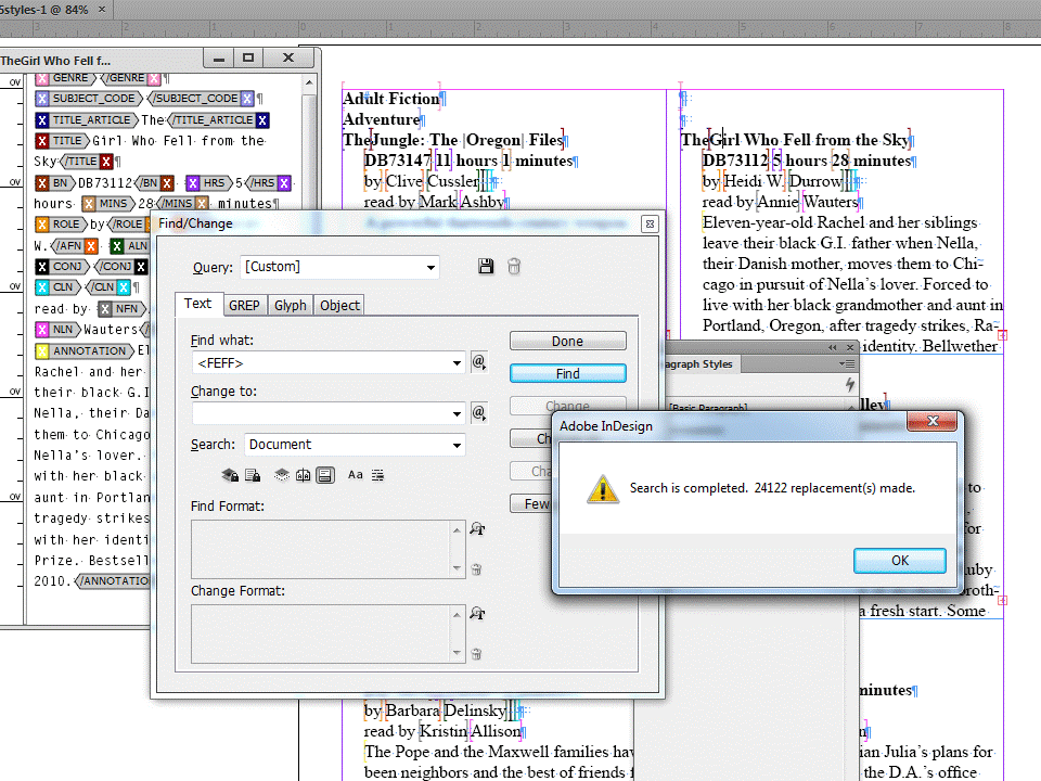

@Lina – this requires a 3-step process:
1. Do the merge (and remember: DO NOT remove blank lines during the merge! Very good advice by Peter!)

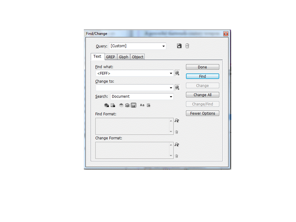

2. Do a TEXT search/replace
Search for (without the quotes): "<FEFF>"
Replace with nothing (= will delete all the special characters, that will prevent the next step!)

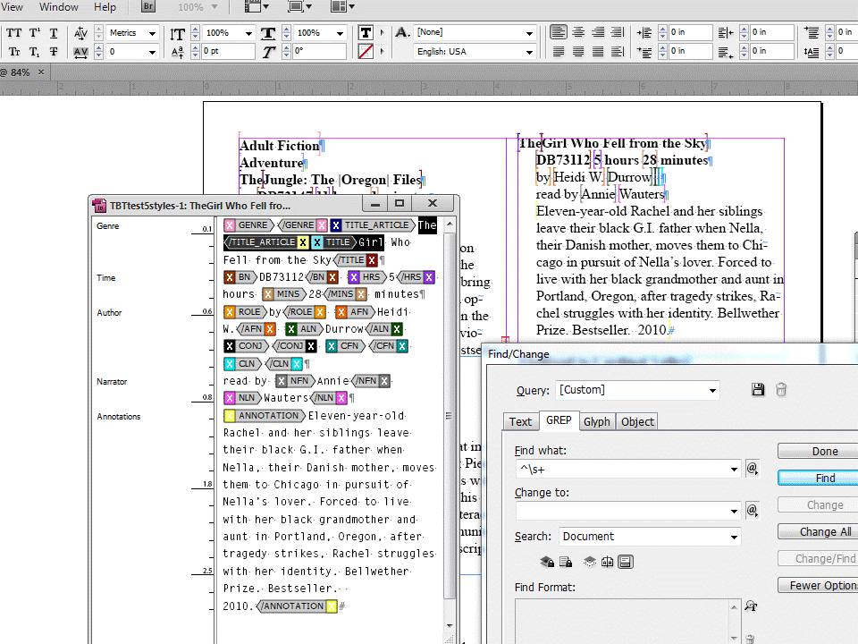

3. Do a GREP search/replace
Search for (without the quotes): "^\s+"

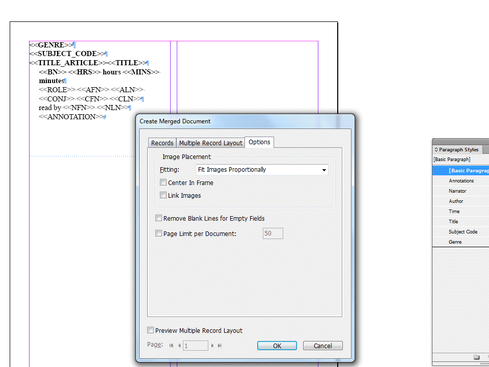

Uwe,
Am I doing something wrong? I've run both searches. I've manage to delete the empty subject code paragraph style fields, but not the empty genre paragraph style fields. I even tried running both searches twice, to see if this would rid me of the empty genre paragraph codes. Here are pictures of what I did:

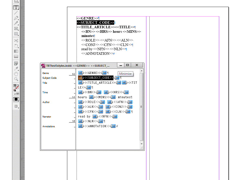

1. Data merge with blank lines included:
2. Merged document with empty genre paragraph style fields and empty subject code paragraph style fields:
3. First text search:
4. Text Search completed:
4. Now the GREP Search:
6. GREP completed:
7. Notice that the Subject Code data merge markers are gone, but the Genre data merge markers remain:
Still hoping that it's user error on my part. Hope to hear from you.

Template master in Story Editor view:
Copy link to clipboard
Copied
OK, that's really strange. The template shows ordinary merge tags, the merged file shows XML tags. I think we need to figure out where the change is happening.
