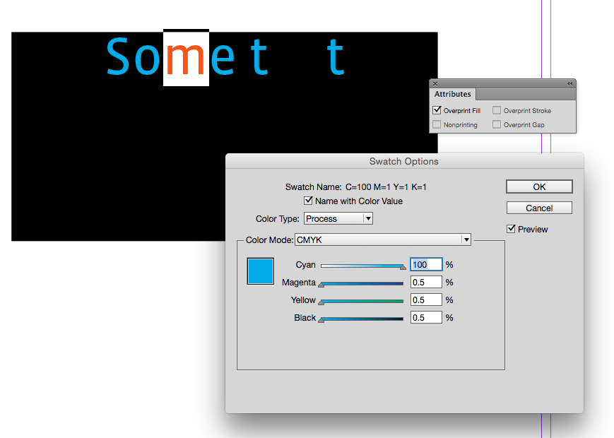

What happens if you add .5% to the MYK of the CMYK text fill? If it really is an overprint problem a color using all 4 channels would have to knockout. Also I assume you tried to save as an IDML and reopen?

A placed link with overprint does not show up as a preflight error in Indesign. The fact that it disappears with overprint preview, sounds like it's a graphic, And would need the overprint turned off in Illustrator.
Nov 30, 2016 Nov 30, 2016
My guess is, that the creator has done this text in black in Illustrator (or even in InDesign itself), after that converted to outlines (which should never be done). Therefore the new object inherited the overprint property of black and after that he changed the color to blue.
If it is an InDesign object (open paths in InDesign), select it and change the overprint attribute to no, if it is an Illustrator file, open it there an do the same in Illustrator.
Blue-overprint becomes invisible in rich black as it here.
Later you have to educate your client that outlining fonts is NEVER a good idea, as this is one of many reasons why it should never be done.

There could be a character style applied to the blue type, with the character style set to overprint, although that should be indicated in the attributes panel (window> output> attributes), if just the blue type is selected.
