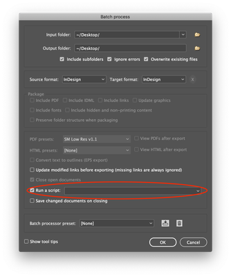

You could use Peter Kahrel's batch_convert.jsx to run either of the scripts I posted to run on all the Indesign documents that need to be proessed in one shot.
https://creativepro.com/files/kahrel/indesign/batch_convert.html

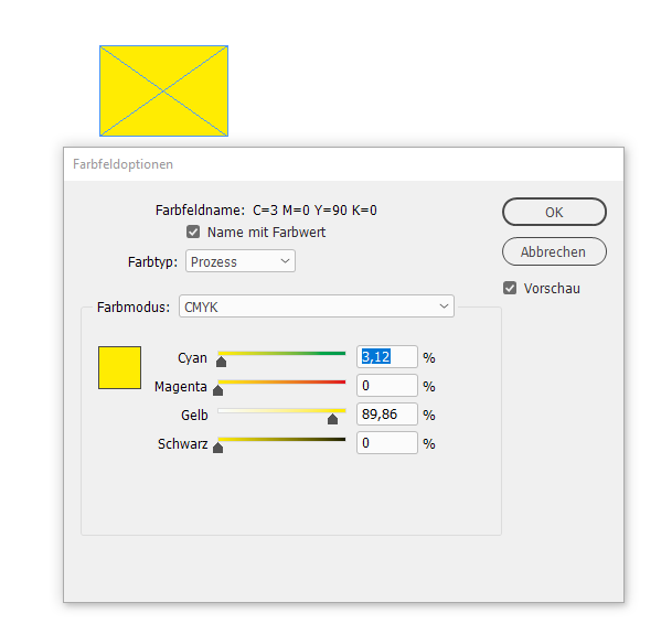

Mike,
to find an unnamed color one could loop the colors of the document and look for an empty string for the name.
If an item is found check the colorValue array. If the values are close* to the values Amanda indicates, store the color to a variable and use that variable with remove().
* I said: "close" to the values, because InDesign's UI will never reveal the super-eaxct values with 13 digits after the dot if necessary. So at best a script could start with a selected object like a rectangle or some text where this color was applied to as fill color. Then it's easy to determine the unnamed color.
Below two screenshots with a sample CMYK color with quite some different values revealed by name in the UI, by color value in the UI and by the "true" color value revealed by a script alert:
Name: C=3 M=0 Y=90 K=0
Values revealed: 3.12, 0, 89.86, 0
You see, InDesign is able do do some rounding when it comes to naming a color after the color values that are revealed in the UI:
Even more, the exact values of the color's colorValue array can only be shown with a script:
Cyan
3.1199999153614
Magenta
Yellow
89.8599982261658
Black

Amanda said:
"Is there a way to have the color change only run on that page?"
Hi Amanda,
on what page exactly?
Brian's script still has the document as scope:
doc.changeColor();
Masters are not included, but still all document pages and all document pasteboards are accessed.
