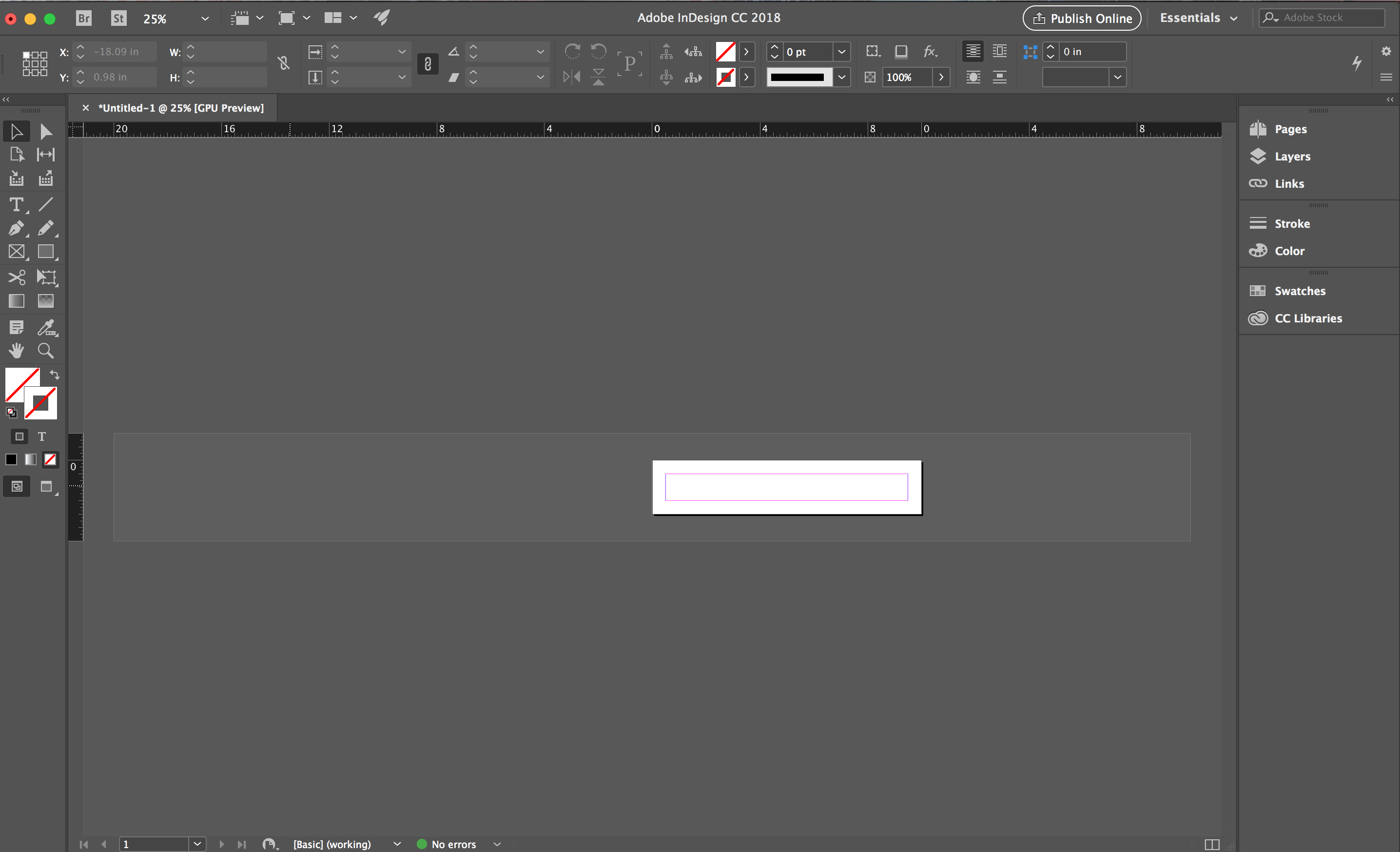

The zero point is marked at the upper-left corner of the page, but there is still a huge amount of space to the left of my actual page in the work area, that I have to scroll back and forth through, unless I zoom very far out. The image I posted is a bit zoomed out due to this, so it isn't super easy to see, but the top left corner of the page is marked as the "0" there. I want the top left corner of the page to be at the top left corner of my window/work space, without needing to scroll through negative 20" of rulered-space.

If I change my zoom level to Command+0 level of zoom, the workspace can fill up my screen as desired, but there is still a ton of unoccupied space to the left of it, that I accidentally scroll into (the lighter gray rectangle in the photo above). Before earlier today when I made the mistake of dragging out a new zero-point from the corner, there was no space to the left of my page in the work area, at any level of zoom.

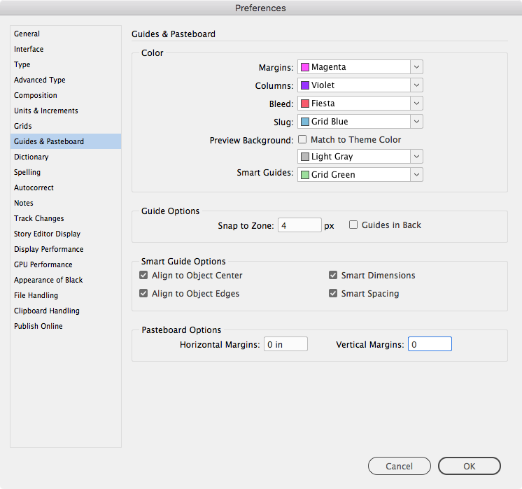

When I set the pasteboard margin from 8.5" to 0", it does subtract that amount from the Pasteboard on the left, but I have no means of collapsing away the remaining ~9"

I think you are misunderstanding how the zero point works—it is relative to the page's trim and not the pasteboard.
You could eliminate the pasteboard, bleed, and slug, with a document set up as non facing pages. In that case there would be no pasteboard or bleed.
So the Pasteboard Options set to 0

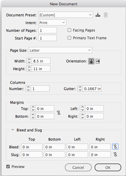

A new doc with no bleed with facing pages turned off:

This is substantively what I want, but was not achieved through undoing my previous error of dragging out the reticle from the top left corner of the workspace. The unchecking of "facing pages" made the difference, but this is not an option that I made changes to before. It seems also like adding a second page now results in the two pages being fully vertically stacked, a condition that was not present previously.
