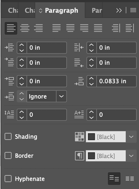

Participant ,
Aug 31, 2022 Aug 31, 2022
Thank you for sharing.  No, I don't have that option, and have no idea how to add it!
Here's my paragraph pallet.  Obviously missing a piece!
