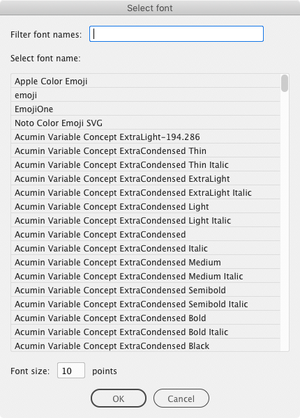

Great news. Thank you for testing it. Could you do one last favor, to satisfy my curiosity? Take a screen capture of the Select Font window and post it, like you did before when it was blank? I'm curious what property ended up valid -- how the font names appear is a clue. Thanks again.

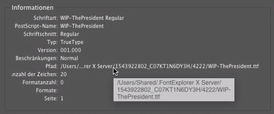

Hi Uwe,
we use FontExplorer as our font management software, so as far as I know the fonts get locally downloaded via the client.
I'm not exactly sure how it's integrated into InDesign since the fonts get not installed in usually used folders (see Screenshot).
FontExplorer uses plugins for font activation but I haven't activated/installed them currently... so not quite sure how this all works.
