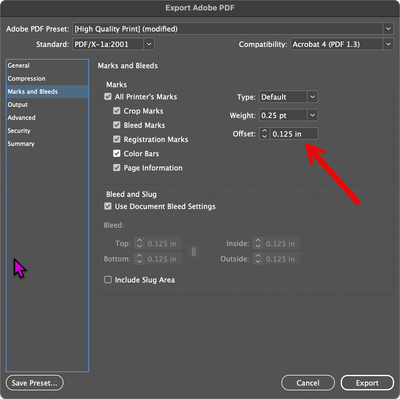

I just want to check that you have the settings set up correctly.
You need to define the bleed in your InDesign document setup, and also in the PDF export settings.

Thank you all. I haven't used InDesign for a few years (and I never used it a lot) and I wasn't doing this right. And, I spent a considerable amount of time screen sharing with Adobe chat and phone support and we didn't get close to the answer. Thanks to this group, I have
  • set  .125" bleeds all around in Document Setup
  • changed the document size to 4 x 6 (not 4.25 x 6.25)
And it looks like I have what I want:

Jun 07, 2025 Jun 07, 2025
That's better!  However, when you export your PDF, you don't need the bleed marks (the outer ones... printers don't need them at all), and the trim marks should be offset so they don't touch the corners of the artwork. The default is ually 6 pt (0.08333"), but printers would actually like it if it was more, so put 9 pt (0.125") in Offset.
Also, printers (I've worked for printers) do not need anything except the trim marks so you can deselect everything in Marks except for trim marks. In fact we don't REALLY need trim marks either, but it won't hurt to have them there. It's good visual reference.

Community-Einsteiger ,
Thank you, now I know what I did when I changed one setting from .0833 to O (with Adobe Support's approval btw). Just set it to .0125
None of the marks can hurt, can they?
"None of the marks can hurt, can they?"
Indeed, there's no harm. All good. They get cropped off anyway.
AKTUELL
When in doubt--turn them all on! 😆
Besides setting your bleed to 0.125 inches or 9 pts, move the crop marks out by the same amount so they don't cut into the bleed area.
