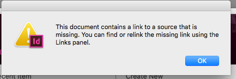

• Recently, whenever I open the INDD files, I get the "source links are missing" pop-up (see Image 1 of the attached six screen grabs). I click OK & the document opens. As expected, the cartoons are pixelated instead of smooth as they ought to be.

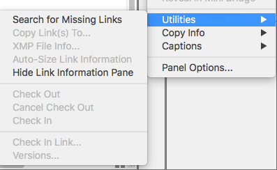

• I select the little arrow within the links panel to see what else I can try, only to see that (Image 3) most of the options (including Relink) are greyed out.
• From this same menu I select Link Options. It opens a pane and I select "Update link when saving document" (Image 4). However when I save the doc and reopen I get the same missing link issue again, so saving the doc fails to update the link.
• I then open Utilities (Image 5) and see that "Search for missing links" appears as a non-greyed-out option. So I click that.

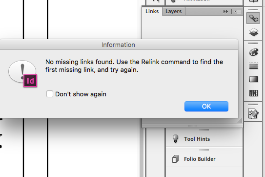

• That opens a new prompt pane (Image 6) that says "No Missing Links Found. Use the Relink command to find the first missing link, and try again." However, as before, the Relink command is greyed-out (see Image 3).
