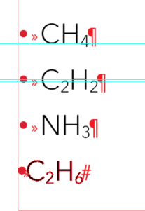

How to outline bullet points InDesign? I read that if I change the bullet points to type in the "paragraph styles" I could outline the bullets. When I did that I lost the tab. The bullet was outlined but I could not move the type horizontally to compensate for the lost tab.

All correct. You cannot preserve bullets if you outline text. Only "manually built" bullets and numbering will survive.
The solution is not to convert text to outline form, something that was once useful long ago but is now (other than for small amounts of relatively large "art text") wholly obsolete.

But no, there's no way to get ID to outline bullets etc. because that text is sort of "not there." If you're doing really large printing, you probably don't have that many bullets or numbers anyway, so just set them up manually. Or find a print provider that doesn't rely on outlined fonts any more.
