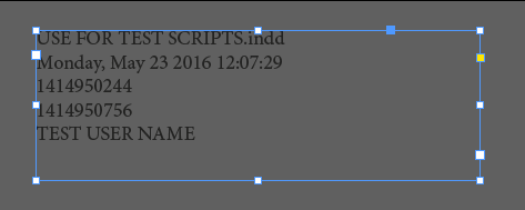

Ok it works.  Kinda.  It places abunch of numbers in the Date Modified and Output area but i need it to convert those #'s into the acutal Time and date.  Just like the Save Date Shown below the File Name. the First number just under the Date is Date modified, and the one below that should be Output date.
Here's how its coded.
var contentsOfFrame =
            doc.name+"\r"+
         /* getLogInUserName() +"\r"+  */
            getLocaleDateString() +"\r"+
            VariableTypes.MODIFICATION_DATE_TYPE +"\r"+ // Whats the Coder for Date Modified?
            VariableTypes.OUTPUT_DATE_TYPE +"\r"+ // Whats the code for Output date?*/
            getAppUserName();
            doc.name+"\r"+
            VariableTypes.MODIFICATION_DATE_TYPE +"\r"+ // Why doesn't this work?  ANd how do i get it to work?
            VariableTypes.OUTPUT_DATE_TYPE  +"\r"+ // Why doesn't this work?  ANd how do i get it to work?
            getAppUserName();
I meant to ask these question on the second time i posted this code.  If you need the rest of the code to see let me know and i'll paste it all on here.

Why this is not working:
You apply an enumerator instance as part of the contents of the text frame. And that is producing a string from a number.
Since JavaScript is weakly typed the number will be automatically converted to a string.
And finally this string is part of the contents of a text frame.

I've tried about 10 different strings and Variables infront of The MOD date and OUTput date and it still shows up those numbers above  Any other ideas?
Advisor ,
May 24, 2016 May 24, 2016
Ok so whats going on is that the Actual Value is working and being placed in the Text frame.  I just need to now tell the script what the value should be translated to?  Because when i get this to show those numbers they are the actual value's shown for that command.  however i'm not telling the script how to translate it. is my thinking correct?
