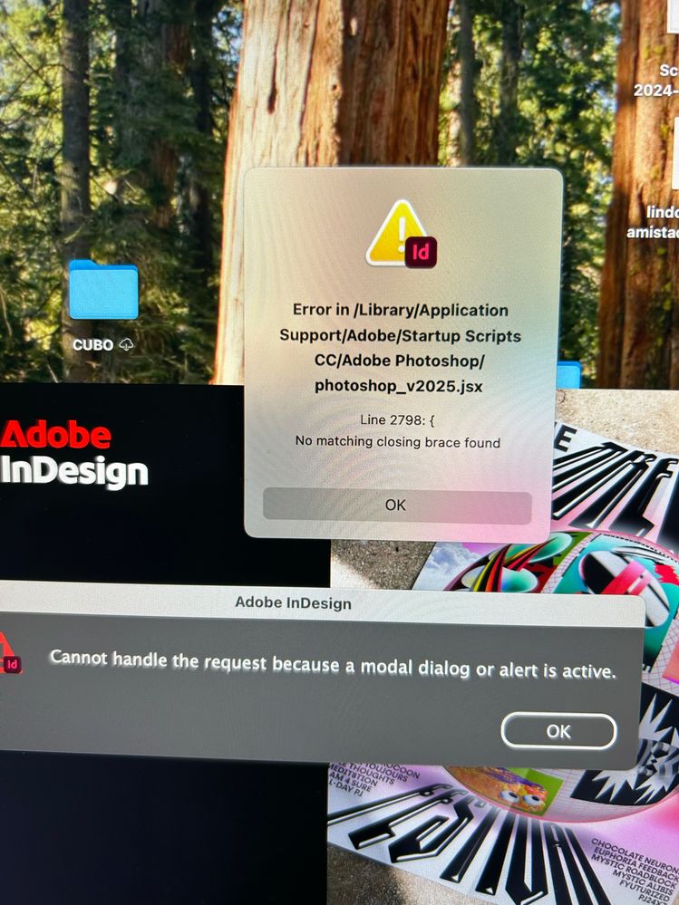

New Here ,
Apr 08, 2025 Apr 08, 2025
Did you try the options in the correct answer?
Like:
  • Workaround 1:
    • Uninstall Photoshop 26.5 (make sure to remove preferences).
    • Reinstall Photoshop 26.5. This will install the correct “photoshop_v2025.jsx”.
Community Beginner ,
I uninstalled and reinstalled it without removing preferences or anything else and it worked fine. I have also seen other user wrote the same.
