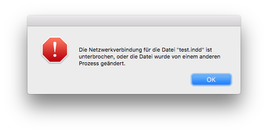

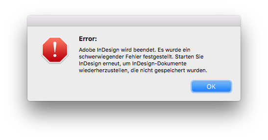

Unfortunately the situation became worse with Adobe CC 2018:
Before the update I could save, open and save as without problems. Just the packaging did not work - screenshot of the error message:Bildschirmfoto 2017-10-25 um 20.01.53.png
Since the update saving a document will result in Indesign crashing. I am not the only one with this problem. See thread here: Re: InDesign CC 2018 Crashing: "The network connection was lost for the file"
and screenshots here (first it says the connection to the nework is lost - not true. After clicking ok Indesign crashes with the next error message):
Restoring (like suggested in the error message) never worked for me from the NAS. Indesing would always say that it can not find the file.
Any ideas?
