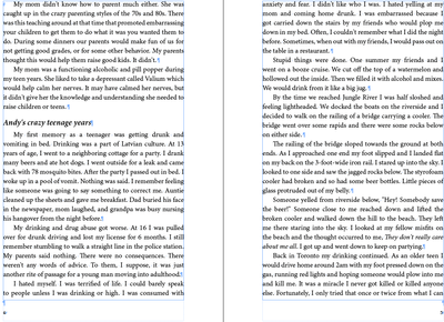

The bottoms of my pages are not lining up. I'm guessing this has to do with spacing I am using before and after sub-headings.
 How do you get the pages to line up on the bottom if you are using spaces before and after subheadings, and using the weight option in paragraph rules to move Chapter headings down the page?
Any and all solutions are appreciated.

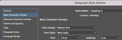

Just a quick comment on lining up text on the bottom of pages for say a 200 page novel. You will need a Paragraph Style for a Sub-Heading that is at the top of a page, and a Paragraph Style for a Sub-Heading that is not at the top of a page.
 See above: Text lines up at bottom of page for Sub-heading not at the top of a page
For a Sub-Heading that is not at the top of a page, Set your "Paragraph Style Options" >> Space before and >> Space After for your headings to equal the multiples of the leading for your font. Example, if your leading for your font is 16pt; then use 16pt, 32pt, etc your heading. Works great. All text lines up at the bottom of the page. See below for set up in Paragraph Styles (Heading 3 is my Sub-heading not at the top of a page).

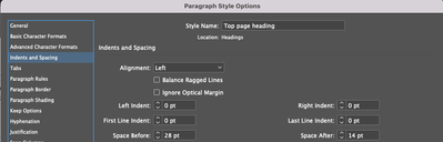

If your Sub-heading is at the top of a page, you need another Paragraph Style to handle this.
 See above: Text lines up at bottom of pages with Sub-heading at top of page.
Below is how I got it to work even though I don't understand mathematically how it works (Paragraph Style is called "Top page heading".
The Space Before and Space After do not add up to a multiple of 16 (like with headings not at the top of pages. But the above works for the whole book.
Hope this helps someone.
