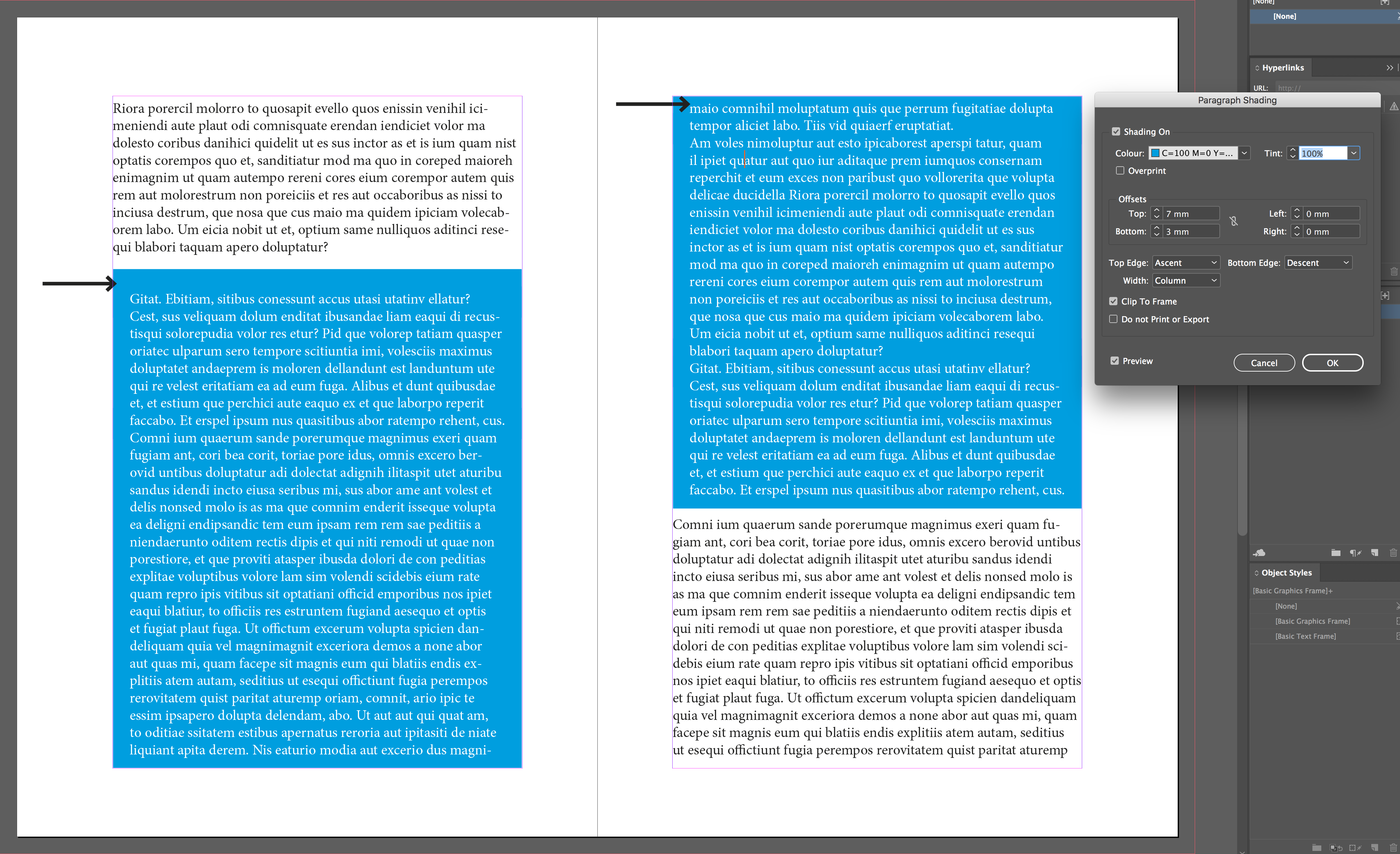

Thanks for your reply. This is all good, but it doesn't address my problem. I'll try to explain it better:
If you have a long paragraph of text that doesn't fit on one page the top offset (padding) has not the same effect if the break happens i the middle of the paragraph. I want the padding to be the same at the top of the second page. This effect varies depending on font and grid spacing. I've attached a screenshot. Skjermbilde 2017-08-31 kl. 12.32.50.png

For some reason when I reproduce what you've done it actually works the way that you're looking for. I tested it both with a Master Frame and by manually threading text from one frame to another. The settings that I did for paragraph shading duplicated yours. Have you tried setting up a paragraph style with this? That would at least make sure that all settings are applied to all paragraphs and might make a difference.
I am also wondering if this is a question of InDesign versions. I am using CC 2017.1. Perhaps you are using an earlier version.
I assume that when you said you have been adjusting this manually you meant that you've been inserting a paragraph return at the end of each page. That would be the simplest way if it doesn't work globally.
Screen shot attached to show what my test looked like:

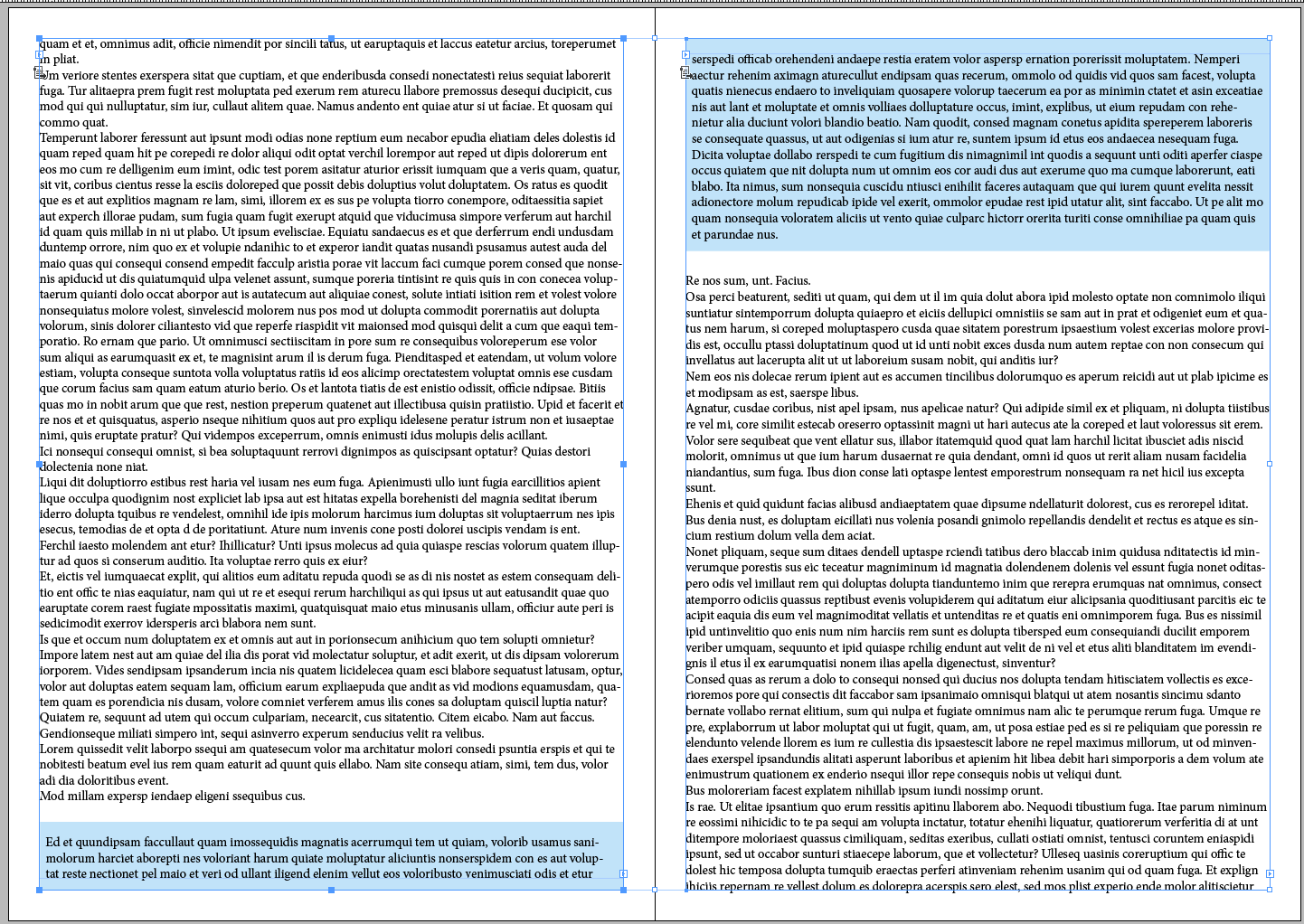

Aug 31, 2017 Aug 31, 2017
Uwe,
Totally! … and it could be done in 1 click on all the doc [before controls] with a simple script!
