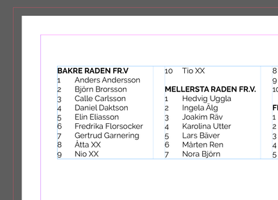

When I'm placing text from a RTF-document all the text ends up to the left in the text box. If I select the text and click "Align to baseline grid" in the Paragraph setting it all spreads out nicely.
When I create a new document, creates a new Text Box and place the same file in that text box, the text appears as it should be (if I check in the Paragraph settings the "Do not align to the baseline grid" is selected.
What setting have I altered in document 1 (when all text appears on top of each other)?
Skärmavbild 2022-05-28 kl. 17.19.25.pngSkärmavbild 2022-05-28 kl. 17.27.58.png

In Addition to the link George has provided I would say that there is a high probability in the first example that the text has been formatted with a very tight leading value, and you can change that in the paragraph style to correct the problem.
New Here ,
May 28, 2022 May 28, 2022
The thing is that my text box is at a Parent page. When I try to fix the leading value at the parent page (having added some text there to see that it looks good), I save the document, remove the text and then try to place the text there again the leading is back to the number is was from the beginning.
I just want an empty text box at the parent page, so that I can create 11 copies from it and adding different text on the 11 pages.
Can it be the leading setting in the RTF-file that somehow affects it?
May 29, 2022 May 29, 2022
Are you "fixing" the leading by adjusting the applied style or by selecting the text and changing the leading value? It sounds like the latter to me, and that would not fix formatting applied on the Parent Page.
You must look at the style you have defined when there is no text in the frame (just an active cursor), and if necessary make corrections there.
It's possible that the formatting is coming in with the .rtf. If you show import options when placing the text you should be able to import as plain unformatted text which would use the style defined in the frame, but would lose any special formatting like bold or italic. It seems unlikely that this is the problem, however if it is not showing in the .rtf outside of InDesign. I wouldn't think that text was set to use leading too small when it was created.

Take a look at your Basic Paragraph Style (possibly the worst thing ever built into InDesign) which is assigned by default to all text that is not assigned a "real" style that you create. Check the leading there, and if it's OK, check the leading value with your text tool active, but no active cursor (that is the default value for all new text) and with an active cursor, but no selection to see if you've accidentally created an override.
Since you say this problem is isolated to a single document, I suspect you've added the leading override accidentally. Defaults are set by making changes with nothing selected. If a document is open, they apply to that document, if no files are open they apply to all new files created after the change.
