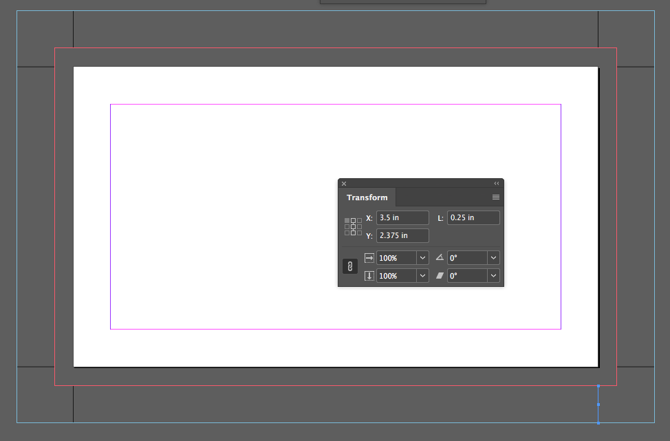

I have a problem with the position measurement of my crop marks.
For example, here is the position of the lower right vertical crop mark. It is wrong. It should be 2.125".
When I Cut/Paste in place, the measurement is now good:
However, if I deselect, and reselect, the problem comes again:
What is going on?
Thanks!
Chris.

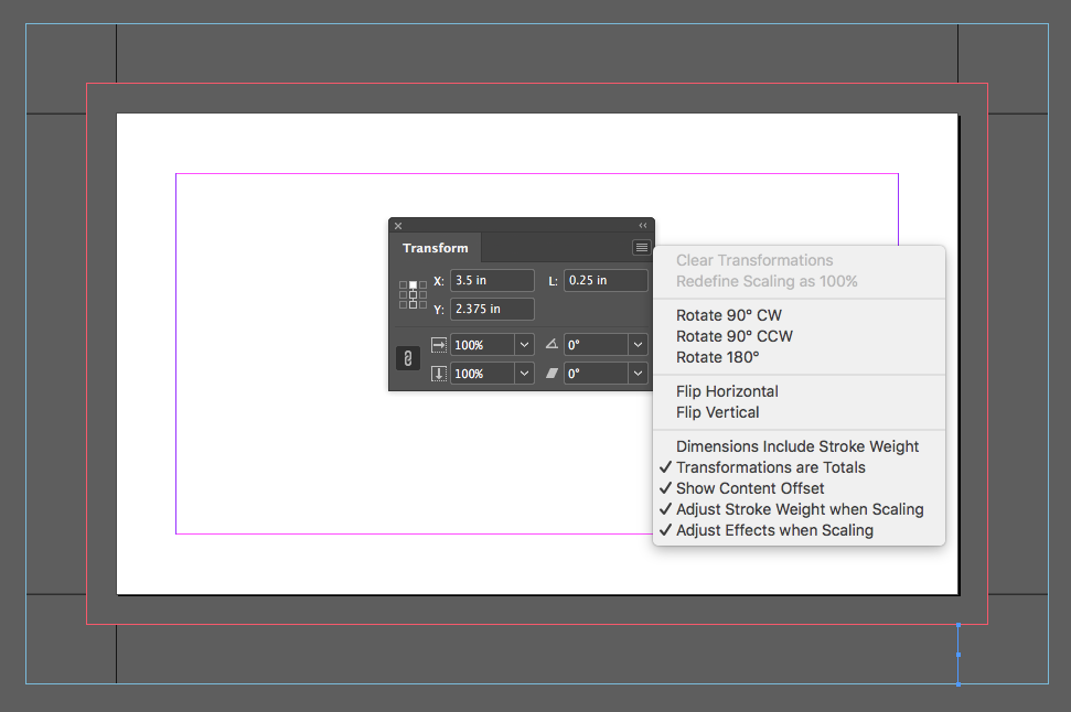

select the top path point with the Direct Selection Tool ( the white arrow tool ) and read out its position. What does it say?
Also check your options of the Transformation Panel. Is stroke weight included or excluded in measurements?

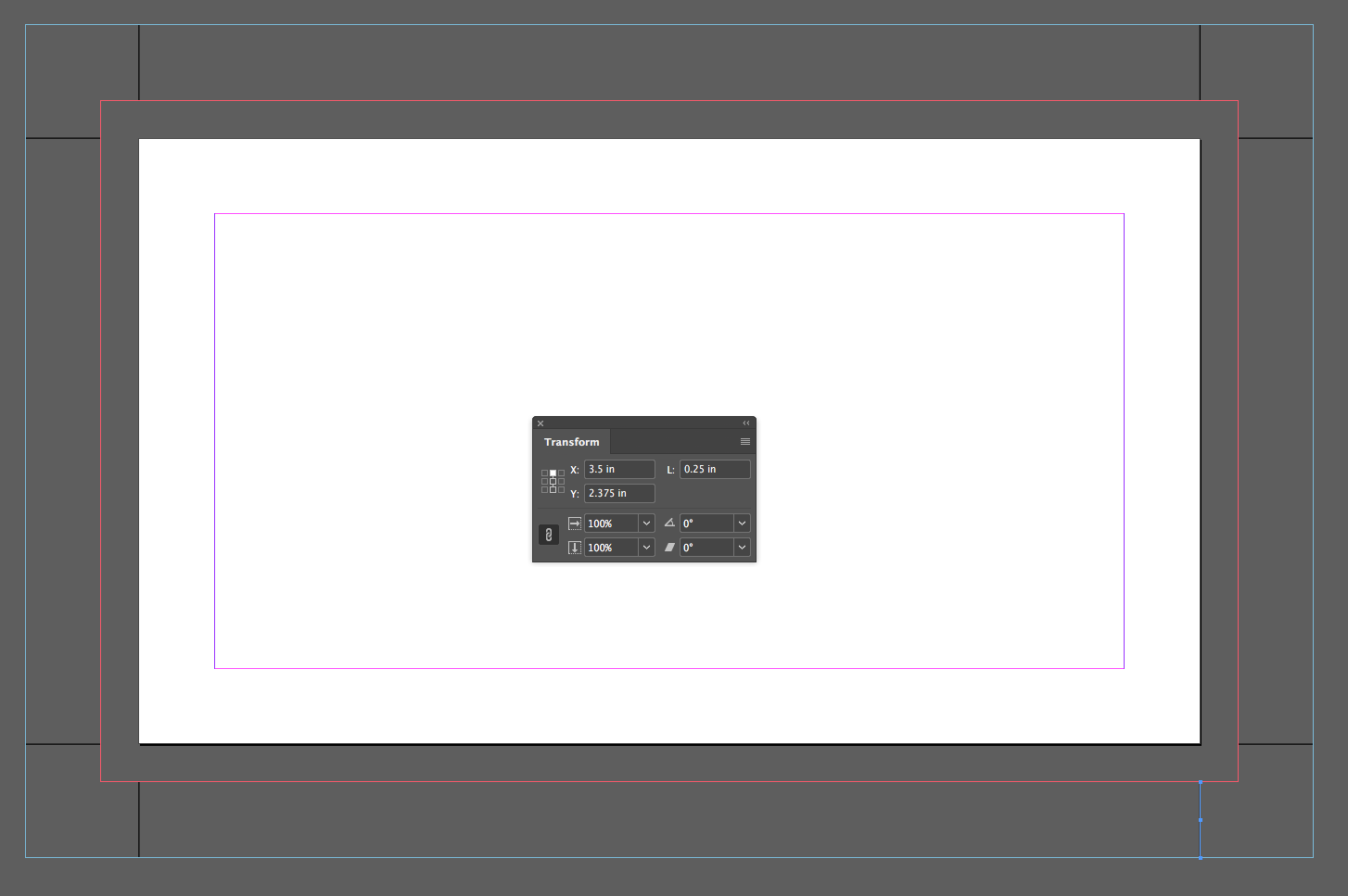

Engaged ,
Jul 17, 2018 Jul 17, 2018
Thanks for your reply!
Here you go!

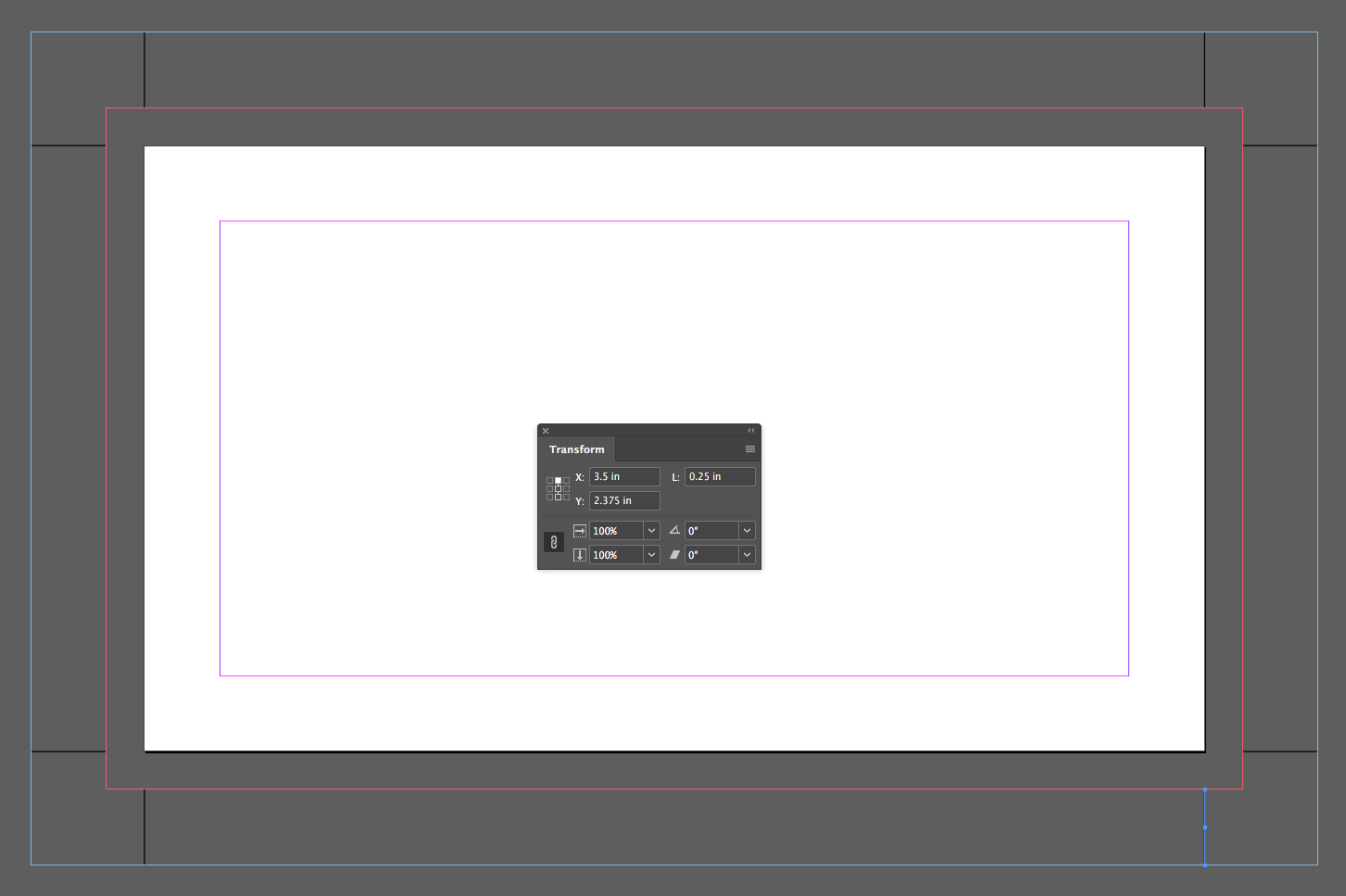

Thanks! However, as you can see, I selected the higher point in the Transformation Panel:
So both path points have the same x-value ?
And if you click all three upper dots of the 9-dots widget you are showing, they all show the same x-value?

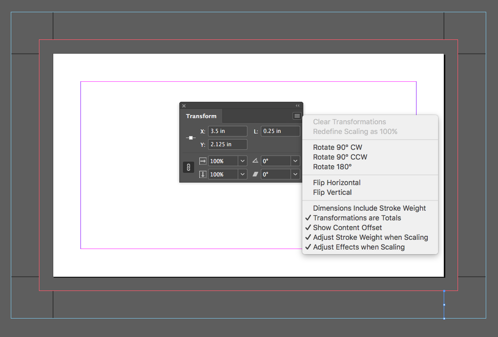

Engaged ,
Nothing makes sense...
Should read 2.125":
Should read 2.125":
Should read 2.125":
Should read 2.375":
The crop mark was selected with the Direct Selection Tool in all the images.
The only measurement that makes sense is when I only select one point like in this image:

It should make no difference, because Dimensions include Stroke Weight is off, but:
What kind of cap is using your stroke? Also miter limit should not affect the result.
