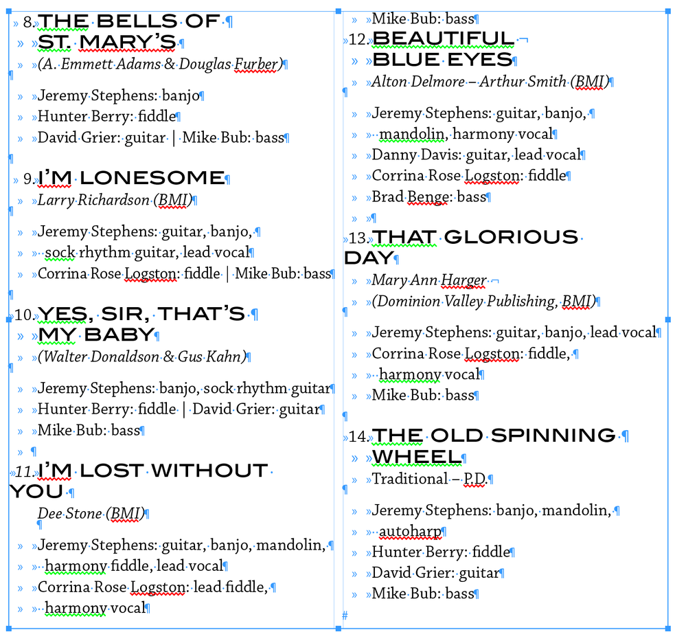

I am unable to keep a 3-letter word from flowing to the next line down - even though there is plenty of room for it on the line above. (see image) I've checked paragraph settings and can find nothing that would force the line to break this way. I looked at the Balance Ragged Lines option and it is unchecked in both places I found the option. Help!

Additional info:  This is a line that has a hanging indent created with two tabs - one decimal tab and one flush-left tab. When I replace the tabs with spaces, the word flows back to the line above where it should be. But I don't want to create my indents with spaces! - that's an amateur move, and prone to misalignment.

Here's a screenshot with hidden items displayed. As you can see, tracks 11 and 13 are both having the same issue.

No we don't know about that one word. I'd like to see the file or at least a screen shot with hidden characters visible. And the style definition to see if there is a GREP style assigning a no break.

I don't know that I have the correct verion of the Blair font, but I can reproduce the problem, both in David's file converted to version 15 and a brand new file in CS6 with freshly typed text using the same formatting (and I sent the file through IDML as well). It happens with Helvetica Neue Pro Heavy Extended as well -- I wanted to try a font I trust -- and seems to happen only in combination with the two tabs.
I think David has uncovered a bug.

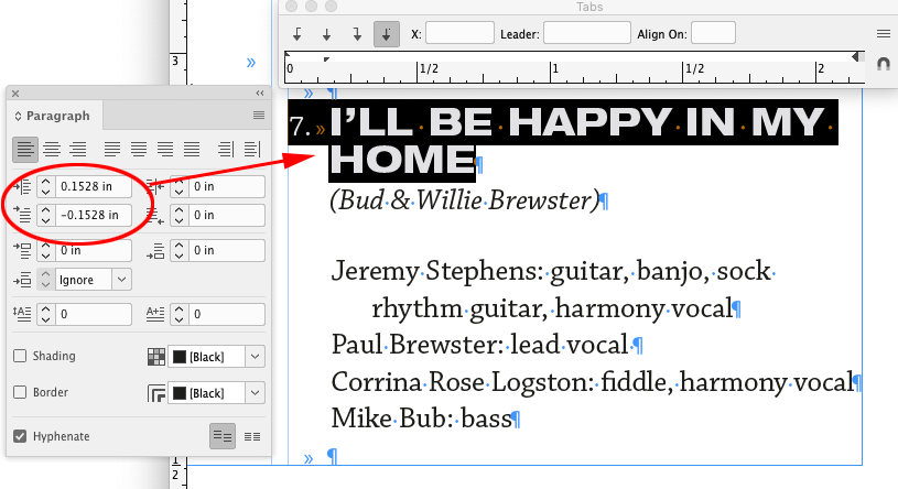

The problem seems to be with the Align to Decimal tab usage. If I replace it with a Right Justified tab it works:
Not sure if this would be a bug—the intended usage for an Align to Decimal tab would be in something like a financial table where you want a column of numbers to align on the decimal.

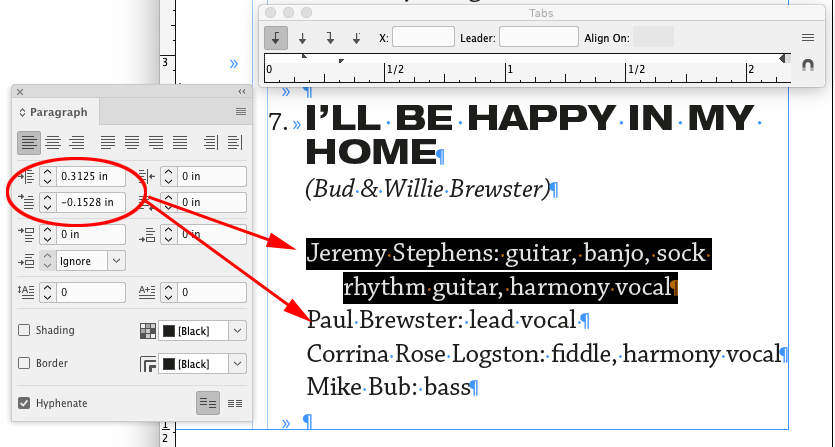

The indents and spacing can be done more consistently with no tabs or empty returns:

Changing the decimal -aligned tab to right aligned seems to work here using the non-list method (which I don't think is optimal for this). Your comment about the usage for the decimal aligned tab got me thinking and adding a non-joiner special character before the second tab also seems to fix the issue.
There is a lot of inconsistency in the way the type is currently set that would be easily eliminated with the proper use of styles, including numbered lists (and a character style applied to the numbers to format them all the same and eliminate the need for overrides or a nested style) and space before/after.
I was able to get the desired alignment with a paragraph style set up as a numbered list, basic character format set to the Blair specs, assign a character style to the number to change it to the smaller Chapparal, and set the number alignment to right, left indent to .1875, first line indent to -.01 and tab to .1875

It can also be done manually with an Indent to Here character—tab>number>tab>Indent to Here. I use this when I want a header right justified to a left justified block of text.
