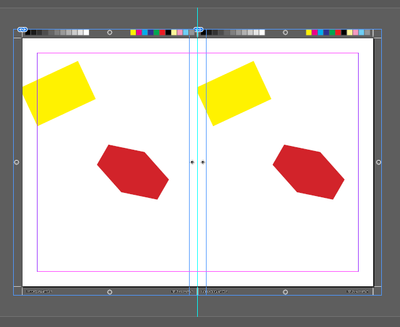

If it's only 16 pages - you can do it "manually".
What I would suggest - export PDF with a name "ImposSource.pdf" - with all the extras - Bleeds, cropmarks, etc. - and then place it on a spreads in a new document - twice the size - with CROP TO MEDIA - then extend OUTSIDE edges of the PDFs to show the extras.
Looks like InDesign "no longer" (??) imports full info but just places cropped version?? Or it never worked like that??
So you would need to do it differently:
- create your document with the same HEIGHT - but twice as WIDE,
- then, using A5 as an example - place PDFs on the LEFT side with CenterX = 297/4 = 74.25mm and CenterY = 210/2 = 105mm, on the RIGHT side - CenterX = 297/4*3 = 222.75mm and CenterY the same as for Left - you can do the math directly in the InDesign:
- then create Guideline in the center - 297/2 = 148.5mm
- then crop PDFs on the inside:
(Sorry for maybe to detailed explanation - but just in case, for others in the future)
Order of the PDFs you can get from the mockup - or from the Booklet Preview.
Then save it as a template "Impos.indd" for future use.
Next time - just re-export "ImposSource.pdf" and refresh links in the "Impos.indd".
Of course the same "techinque" can be used for longer publications - even when folding is required.
