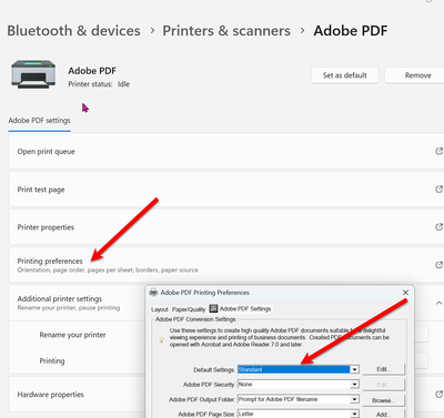

The Adobe PDF Printer for Windows uses the default settings under the system settings or when creating a booklet unless one changes them.
System settings:
Also, one should turn this off:

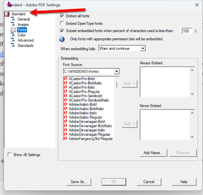

I'm not in front of my Mac right now, but it has to use the PostScript driver to create the PostScript file, then that has to be run through Distiller with the appropriate settings.
The Distiller setting has the font embedding preferences.
On could try setting the fonts in question to always embed.
