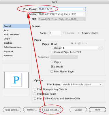

On the Mac side I have to save 2 different presets, one for the InDesign specific setting, and one for the print driver settings—it looks like you also have a separate  Save.. button (the 3rd capture showing your printer specific settings)?
With the Mac dialogs, if there is a duplicate setting like Page Range, the InDesign Print dialog setting is used:
