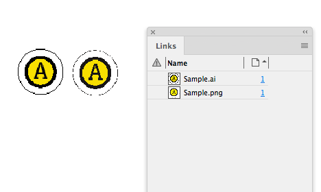

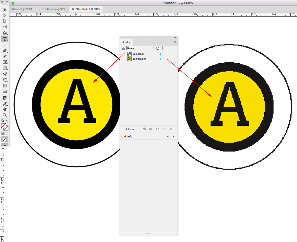

If the .ai file is placed it shouldn’t print jagged—vector object have no resolution. The jaggedness could be your display performance setting. The display setting and zoom magnification will affect the preview, but not the output:
Typical Zoomed out:
High Quality display zoomed out:
Zoomed in you can see the vector is better than the PNG:
If a composite printer is printing it jagged there's something wrong happening in the driver or the link is missing. For offset printing you would never want to use a bitmap image in place of a vector object
