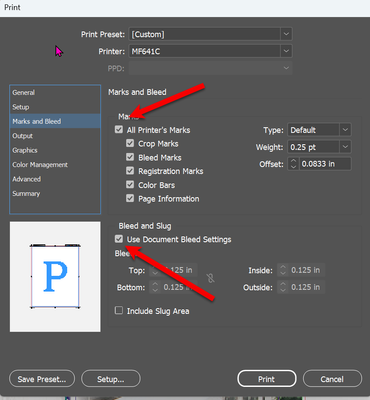

Are you printing directly from InDesign or from a PDF created by InDesign?
If InDesign, turn off these settings:
You still won't print the entire page as most printers do not print edge-to-edge. Only a few inkjets and usually for photography purposes.

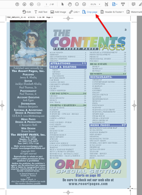

If from a PDF, you will need to crop out the bleed.
