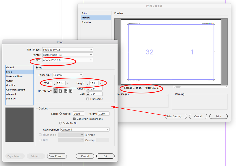

If there really is no way the printer will handle the imposition, you need the Adobe PDF 9.0 PPD—Device Independent doesn’t work that's why your pages are getting cropped. If there are blank pages check Print Blank Pages under General in Print Settings.
If you don’t have the PPD there is a link to the download page at the end of this thread
