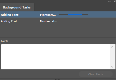

I'm having an trouble the background task feature on InDesign. I downloaded two fonts from DaFont to spice up my magazine, and since then I haven't been able to save or export my document because it is continuously "activating font" under background tasks and isn't stopping. There is no option to delete (see picture). Has anyone had experience with this? I'm afraid to ctrl-alt-delete because I don't want my document to not be saved.

My fix was to see which fonts it was trying to activate, mainly it was fonts like @rob day said, that were on both Google Fonts and Adobe Fonts, so I uninstalled the font and reinstalled it. I also kept the auto activate on, since it's so helpful.

THIS!  Thank you, Bera! You jogged my memory. We had the same issue with Montserrat, which is both a Google font and an Adobe font. As soon as I deleted the Google font, it allowed Adobe to "see the path" to activating the fonts I needed.  Bebas was the font in question for the curious font folks.  I believe it is also an Apple system Font, which also may be another little wrinkle that I just worked out.  THANK YOU!

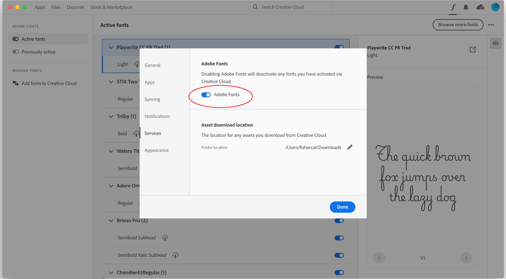

Hi @davida58128891 , You don’t have to use Adobe Fonts or allow them to activate. From your Creative Cloud app’s Preferences choose Services and disable Adobe Fonts, and with no docs open uncheck Prefs>File Handling>Fonts>Auto-activate Adobe Fonts
