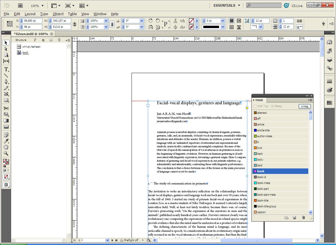

Nov 21, 2011 Nov 21, 2011
@Green4ever:
… but "Untag Frame" is a valid menu action. It is activated after you select any  text frame and right cilck it. …
I can click it in the UI, but therefore it's not necessarily part of the menu actions.
Jongware's suggestion is working in my test case:
app.selection[0].associatedXMLElement.untag();
My suggestion for untagging is okay, if you want to use menu actions:
First select the object and then:
app.menuActions.itemByID(78612).invoke();
My test case consists of a single rectangle autotagged and selected.
If that is not working for you, I think we just need a test IDML for playing around…
Uwe
@Green4ever:
app.menuActions.itemByID(78612); performs same action when it is Untag Text or Untag Frame.
Of course! There are no inconsitencies in that behaviour. The menu action with ID 78612 is the little "Untag" button in your screen shot.
It can untag all kind of objects that have tags.
Uwe

Enthusiast ,
Hi Jongware,
But you cannot tag a text frame as a root element ...
Yes you can, It is possible. See the screen shot. Just drag a text frame to your sturcture pane's root element and it is done.RootTag.JPG

Enthusiast ,
Nov 22, 2011 Nov 22, 2011
Yes of course!.. You cannot delete the root element. But you can break the association. To do this, select the associated text frame and invoke the menu action.
