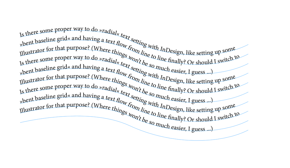

InDesign does have type on a path. As a work-around, you could make one path and step and repeat it, (or make a set of concentric circles) then paste long text into the top path and add the overset type to the other paths. Hiding the top path after loading the overset type will make it easier to select the next path and flow the text.

Thank you, Luke!
Let’s assume I’ve just built up some very nice concentric »baseline grid« in Illustrator: I found not way to import that to InDesign so that I could use it there to follow your work-around suggestion 😞
Jul 16, 2020 Jul 16, 2020
If you drew those paths in Illustrator, wouldn't you (assuming these are simple paths) likely copy n paste those paths to InDesign? Then, in InDesign, you would have to make them all type-on-a-paths; link/thread them together; then flow in your text. Not a quick process, but the effect is pretty cool.
