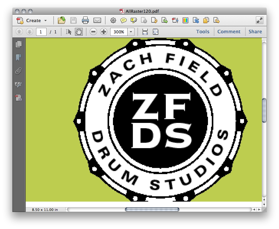

Dec 09, 2012 Dec 09, 2012
Does not seem to work. I tried a slight different approach as setting all vector images to 99.9% is too cumbersome.
I got it to work by drawing a frame over the page and setting its opacity to 0%, then Exporting to PDF/X-1a. Make sure you export a flattened PDF and with the custom flattener preset chosen in Advanced.
An AI logo is rasterized to 120ppi on export
Community Beginner ,
Mar 28, 2016 Mar 28, 2016
Works perfectly.  Thanks!
