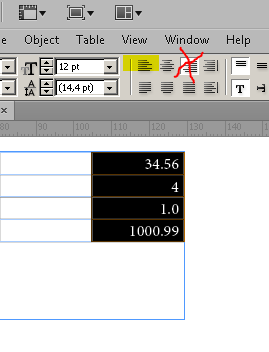

Jarek's script works fine for me. A very good demonstration. You just need to create a test doument and add a single table to it. (It will not work on any given document.) This forum is a place to share and learn, and to get tips on how to make scripts. Often you will not get complete solutions.
Here is an alternate suggestion: you could create a paragraph style with the tabs set as Jarek describes.
Define the alignment character on the tabs tab of the paragraph style dialogue. Then, in your script, just assign that paragraph style to the selection of your document.
There is another thing that is relevant to add: you need to have the the cell contents LEFT aligned. Any other alignment will ruin the "Align to decimal" setting!
On the image below, the text is RIGHT aligned. That is why my text is not paying attention to the Align to decimal setting (that is also assigned).
