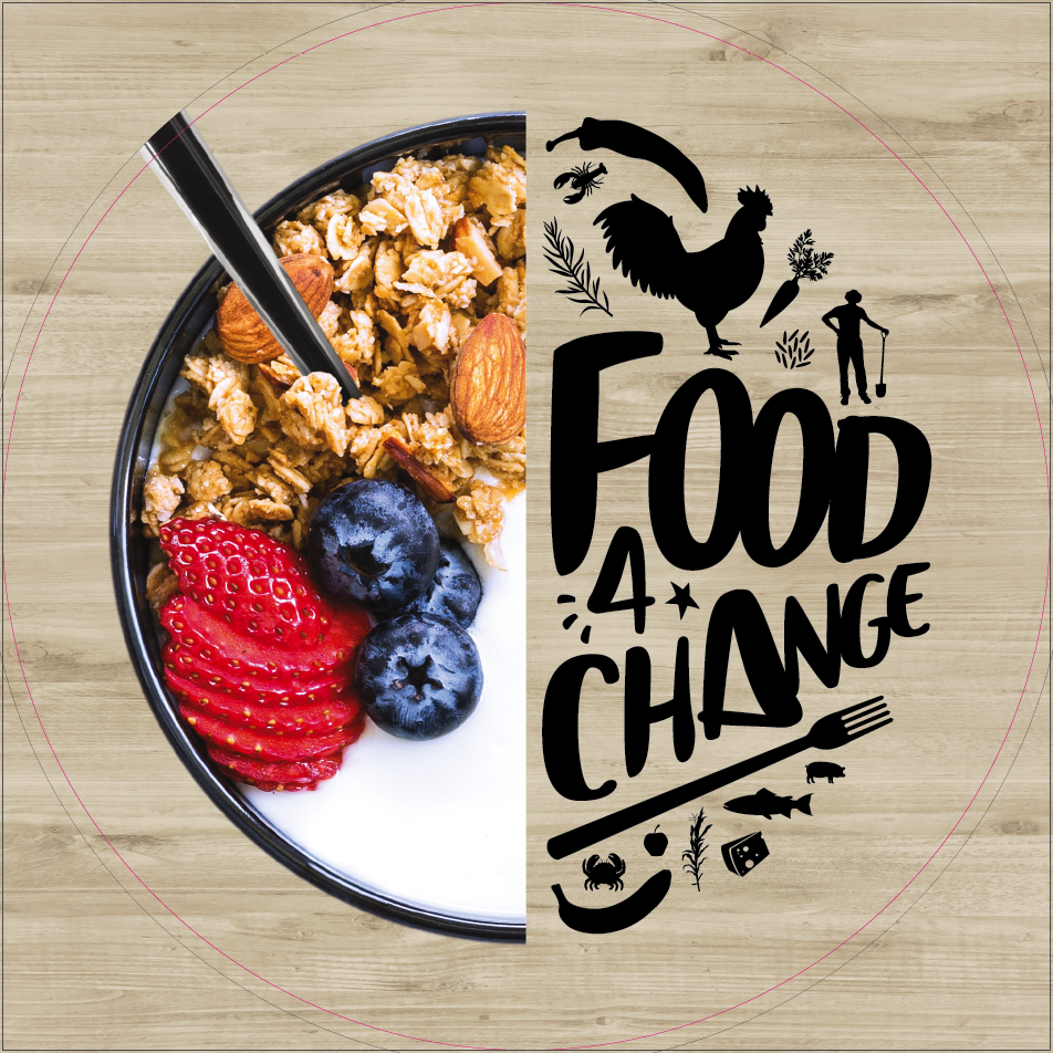

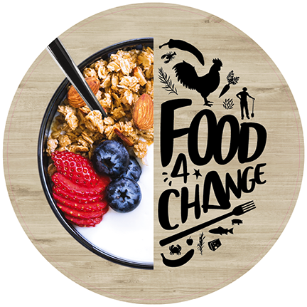

Simple, need to follow the reverse way of making it mask.
Place the mouse over the masked object. The mouse pointer converted to a 'hand'. Please notice the dual circle where a white circle around a small, dark grey colored circle appears in middle. That 'dual circle' indicates to select the masked source object/picture, so, select it and use 'Ctrl+X' or 'Command+X' to cut it. Now deselect the mask frame and use 'Ctrl+V' or 'Command+V' to paste it.
Look, it has been released. Added a sample photo
