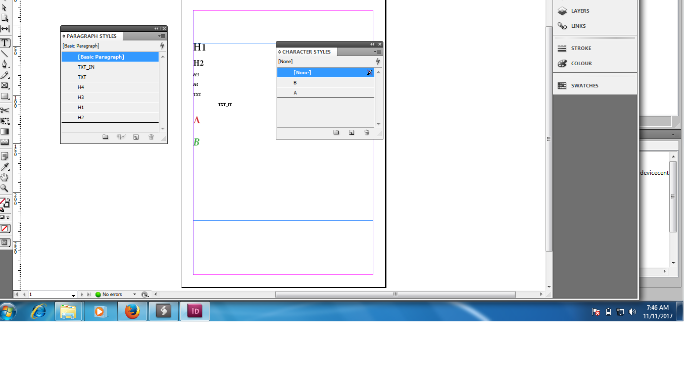

Hi All,
I want to rename the Pstyles, Cstyles etc..names using excel. I have use the below script its also working in activeDocument.
Now i have 100 inDesign documents so i will go to batch process. Any advice would be greatly appreciated.

I have attached csv format:
