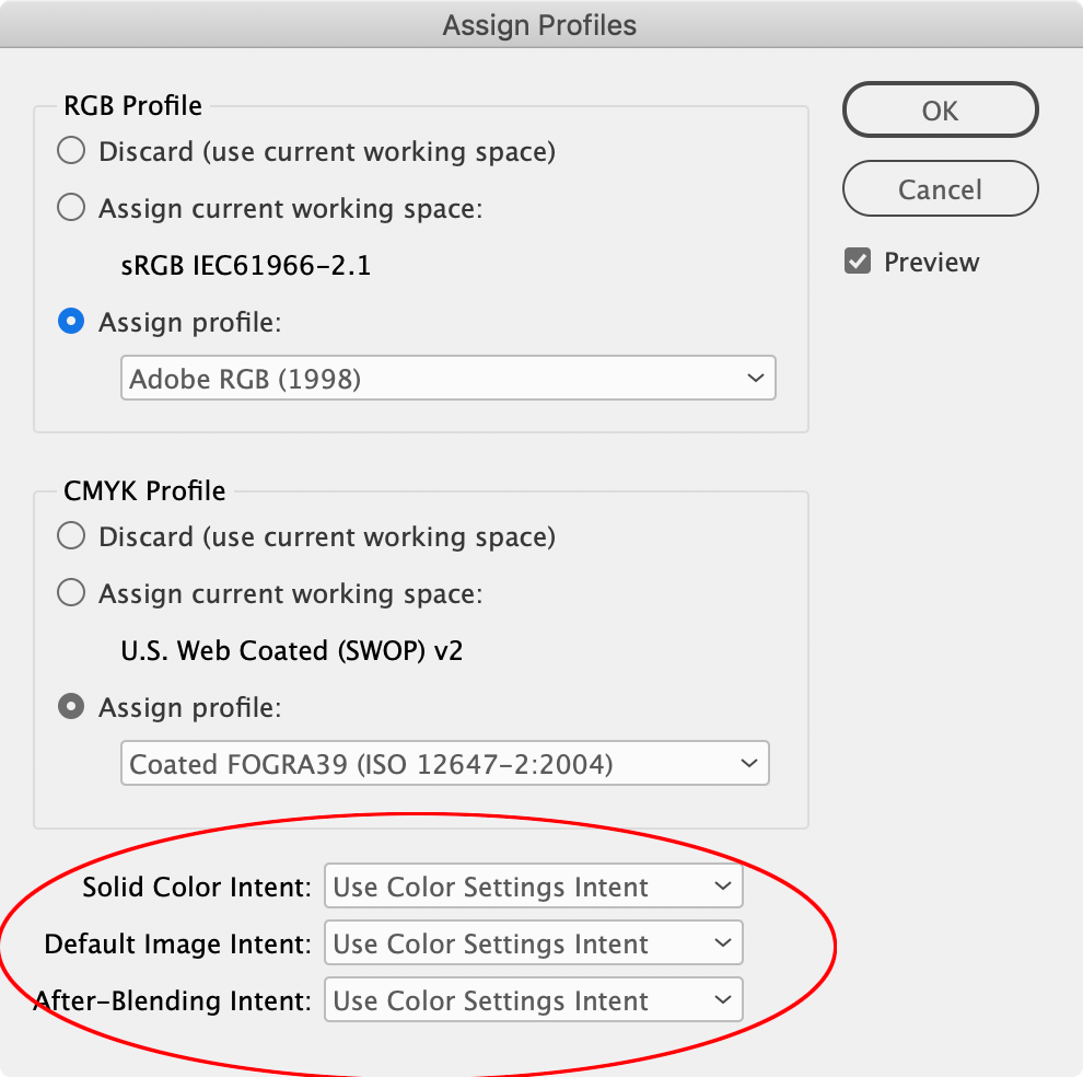

Also, the Conversion Options affect the exported CMYK values, by default your current Color Settings’ Conversion Options are used:
Or, you can override Color Settings and set the options for the document  in Edit>Assign Profiles...
