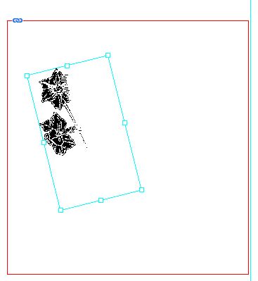

Community-Einsteiger ,
Aug 12, 2018 Aug 12, 2018

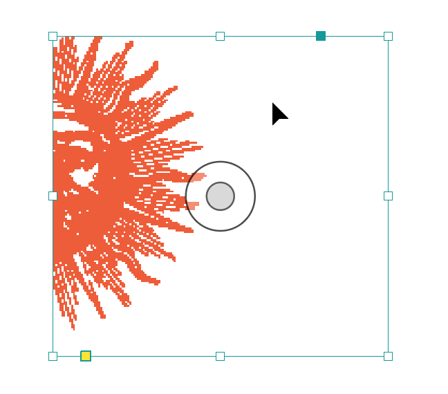

The image rotated so it is not completedly contained within your graphic frame so you're seeing that it's "cropped" out.
You can use the 2nd tool from the top (Direct Selection or "white arrow" tool) to click on the image and drag it within the frame so you can see it again (see illustrations below):

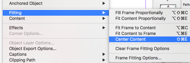

Rotate the frame with its content (image).
You can use content grabber, or double click inside the frame, or use the white arrow to select the image inside the frame, and move it.
also you can use fitting, Object> Fitting> Center Content

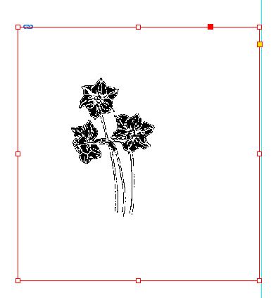

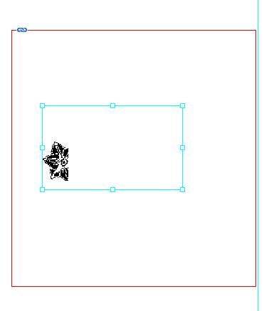

New document. File/place – using corner tool on frame, rotate. Image is visible in small portion. No matter what I do from here I cannot seem to get the 90 degree rotated image to appear. If I rotate 180 degrees image is visible. See screen shots of settings and use of black arrow as tool from top of tool bar on left.
Image inserted into new document using File/place
Image rotated 90 degrees using corner rotate tool on frame.
