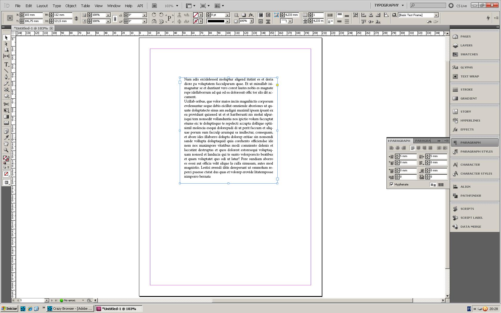

Is there a way to create a script to increase/decrease left margin and right margin in texframe?
Example:
If I select my textframe (Leftt: 0mm, Right: 0mm) with Tool Selection, and apply the script by shortcut to increase or decrease the margins 1mm to 1mm.
I use milimeters here in Brazil.
Thanks!!

Hmm, sorry. Maybe I couldnt explain.
I mean Increase/Decrease equalon both sides: Right Indent and Left Indent:
