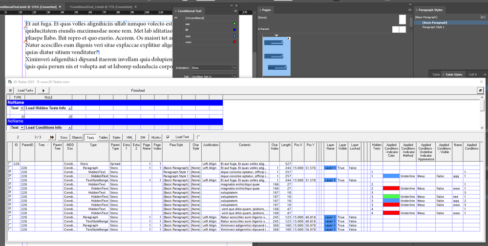

LEGEND ,
Jan 07, 2025 Jan 07, 2025
@jrsupplee
Get HIDDEN Texts first:
But then, you need to do a 2nd run on them - check which Condition(s) is(are) applied.
Screenshot shows raw text at the top with all conditional texts hidden.
Below you can see my ID-Tasker tool - this part is free - effect of first loading Hidden texts - then 2nd run that analyses those Hidden Texts and loads info about applied Conditions to them.
2nd, indented, copies of "HiddenText" should be renamed to "Conditional Text" - it's a quick test so I haven't done this yet.
CharIndex column is misleading - during 1st run, InDesign returns indexes of texts EXCLUDING hidden texts - so when I've done 2nd run - the 1st hidden text on the above list is in fact FIRST paragraph:
And there are no Page Names / Indexes - hidden textts don't have Parent TextFrames, Layers, etc.
There is one drawback - not sure if/how would you be able to store this information - but after showing Conditional texts in InDesign - when I try to access location of the Hidden Texts - loaded during 1st run, when conditions were hidden - InDesign return error that object no longer exists. Not a problem for my IDT - but it might be a problem for you.

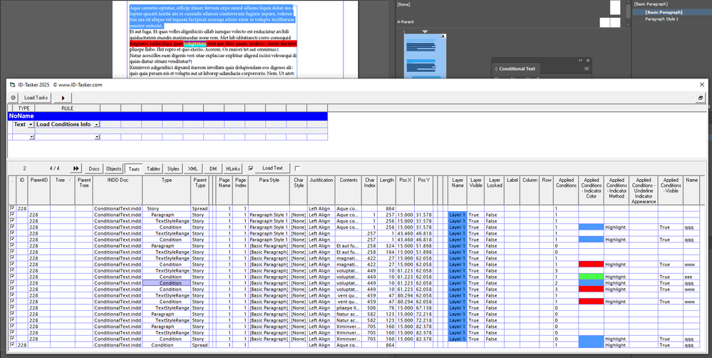

LEGEND ,
@m1b
It might not be clear from my earlier screenshots - so here is a more clear example.
The whole text has exactly the same formatting - Minion Pro Regular, 12pt:
I've downloaded contents of the last Paragraph as separate characters - then loaded info about Hidden texts - for the whole Paragraph.
From the CharIndex column - you can see where each condition is anchored - marked with a green frame in the text. I should've rather selected "Character" with the index of 974 - 3 rows earlier.
And here is the "complete" text - with all hidden conditions visible:
So, for each piece of text, you can retrieve HiddenTexts collection - and from there, you can get its anchoring point - StoryOffset of the Hidden text - and then get a reference of the previous or next character to get ParentTextFrame.
