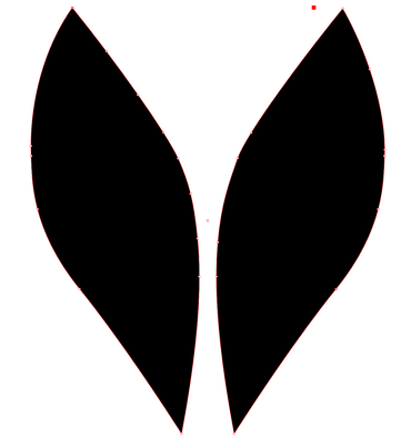

I am looking for a script that will work similar to Zamena script (for Illustrator). I need to swap the geometry of a bunch of objects that I've created in InDesign. After I made many, many copies of the object in question, I took a closer look at the bezier curves and they are not as clean as I would like. So I want to swap their geometry with a newer cleaner version.

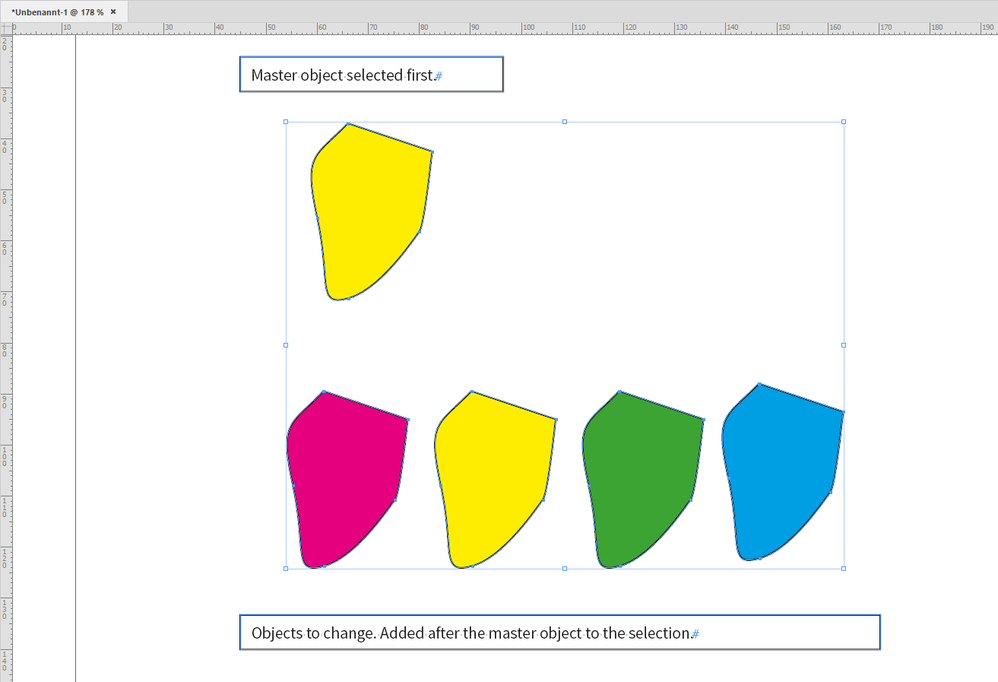

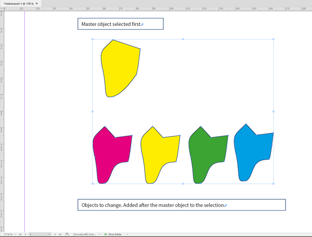

To illustrate what my script is doing.
Before running the script on that selection:
After running the script:
Path and position of the master is applied to all selected objects.
All other properties like stroke weight, stroke color, fill color are not transferred.
