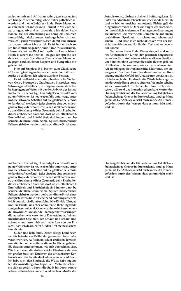

I bet there’s no script for controlling whether or not the last page of a book’s chapter carries a page number (at the bottom), depending on how much of that page is filled with text.
Will somebody proof me wrong here, please? 😉
See this pic of two double-page spreads, showing situations where you might or might not want a page number at a chapter’s end:

Doable with some effort, but why not just use a different master page without the number?
Why does the first one take a page number whereas the second one doesn't?

Re your 2nd question: Just for »book setting aesthetical« reasons. Some people (like me) feel that the fewer lines a chapter ending page has, the more a »lonely« page number at its bottom looks just inapt and unmindful.

As Brian suggested, create a master for those pages. Then a script can determine whether a page contains, say, five lines or fewer and apply that master to the page.
