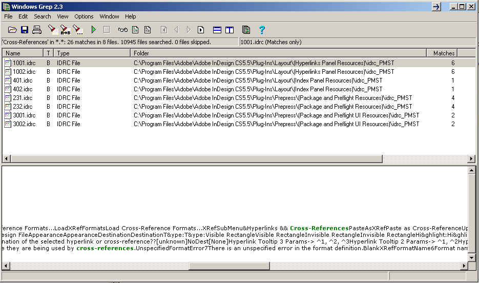

The names themselves seemed to be stored in .idrc files, located somewhere in the Adobe InDesign CS5.5\Plug-Ins\Layout\(SOMETHING)/idrc_PMST directory. Rather than poking around let's do a smart search.
Step #1: Download any utility capable of searching binary files, e.g.: http://www.wingrep.com/download.htm
Step #2: Search for a single word in what you want (e.g.: I searched for cross-reference), look at the results list. You can probably guess which file you want - in this case it was one in the 'Hyperlinks Panel Resources', which made sense:
Step #3: Open the file in a text editor. Find the english-like name of what you want, and immediatly preceeding that will be the InDesign keyword. To double-check run the english-like name through the app.findKeyStrings() function:
I wasn't too sure on the .idrc file format, it seems pretty basic. You can open it in a hex editor if you want to see all the binary data, perhaps we could make a script dump everything...
