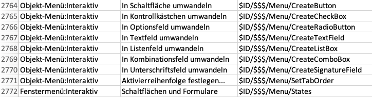

In the post invoking menu - language it is described, how to get the locale-independent version of a menu string
From what I understood, the ID of a menu action is not reliable. Obviousely the same applies to localized menu strings.
I made a small script, to get a list of all menu strings. The basic idea is from How to open any menu item …
My script uses Peter Karels scrollable alert to show the result.
The result is tab-delimited and can be pasted to a spreadsheet:

Here are the menu strings to convert an object to any interactive item:
