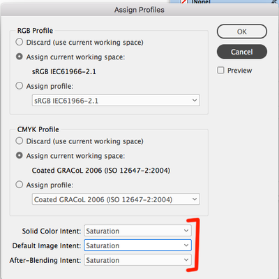

Once you Assign a rendering intent in the ID document, it should carry through.
Here's a simple test. Make a couple of files from a document with some LAB values you want to test.
It doesn't matter so much what your specific Color Settings rendering intents are (usually Relative Colorimetric), as you can override them in Assign Profile.
File 1, leave as default. Under Assign Profle leave the rendering intents as they are.
File 2, change the Rendering Intent to one you want to test, say Saturation. If you are only concerned about ID's object colors, just change the first item.
File 3, change to another, say Perceptual.
Export PDFs, No Conversion.
Even in Acrobat you will see the difference between the three files when you Preview selecting the Output Destination you desire. You can also test-render them into Photoshop to CMYK, as CMYK is pretty much where you are really concerned about how things convert.

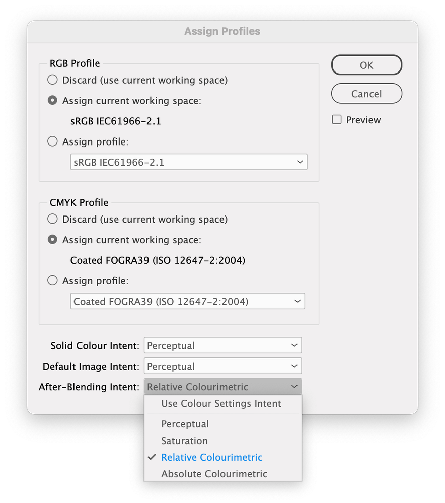

LAB rendering intent is set in the Colour settings, note that this is for new documents and that when you open a document this may have other settings and you may want to  look at the Assign Document Profiles. The Solid colour rednering intent and the After-Blending intent both play in.
I would recommend using Perceptual for Solid intet if you have LAB since I don't see an option for Black Point Complensation. After Blending intent comes into paly when you have transparent objects. It is complicated and many parameters.
