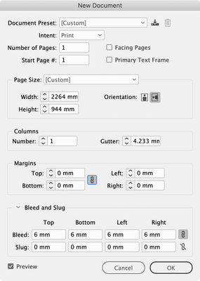

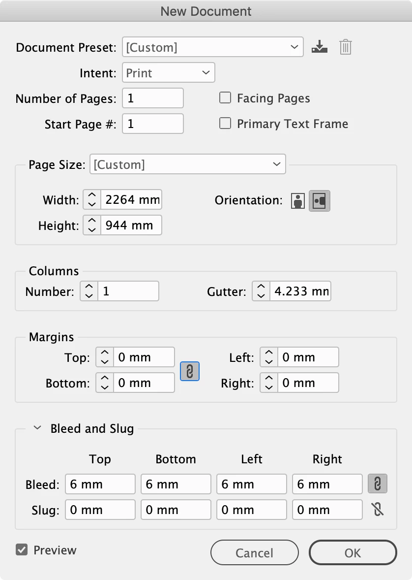

Hi @Kieran37958349aj0z , Your banner size is well within InDesign’s 216 inch size limit, so your page setup can be something like this—If the print area goes to the edges of the banner you will need to include some bleed amount:
