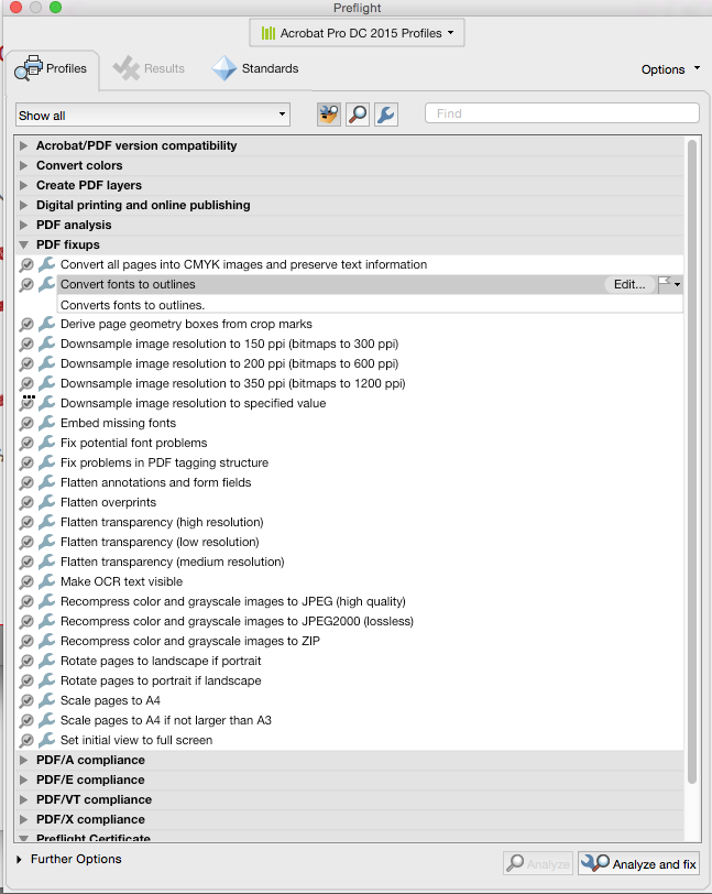

You can use AcrobatPro to convert a PDF's fonts to outline. Choose Print Production>Preflight>PDFFixups>Convert Fonts to Outlines. You'll be asked to Save As. You can check Document Properties>Fonts to make sure the saved doc has no fonts.

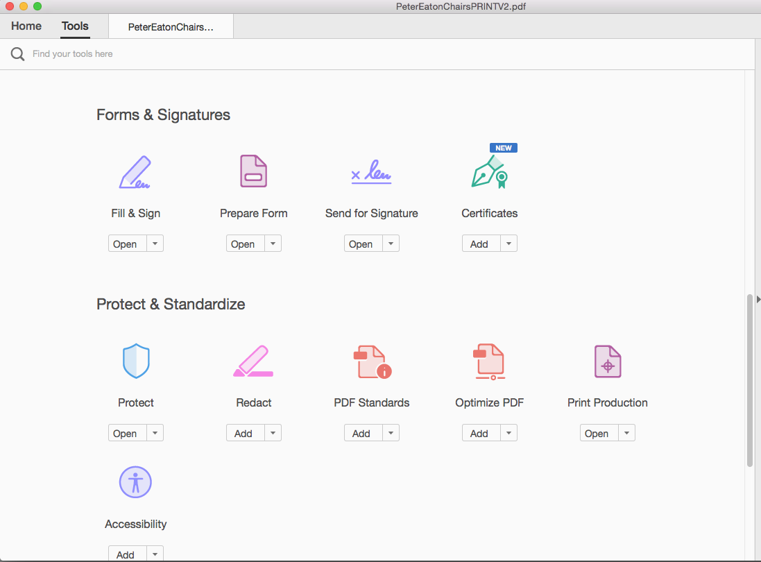

I tried looking for the "Print Production" command that Rob Day mentioned in Acrobat Pro CC, but it wasn't there.
Jun 21, 2017 Jun 21, 2017

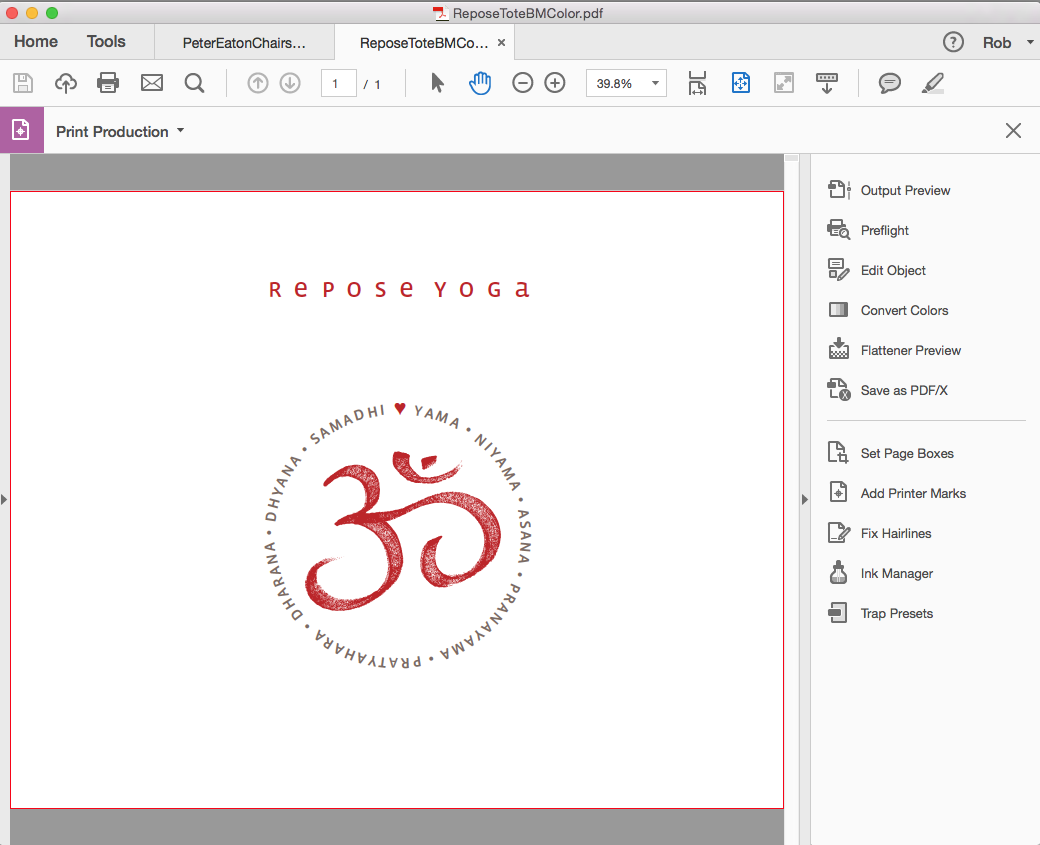

Look for the Print Production Icon under Tools, which will give you the Print Production sidebar:
Click Preflight
