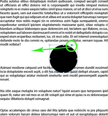

Drag this node anywhere into the text

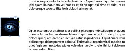

Anchored objects are given this icon:
Holding down Alt when double clicking the icon opens up the Dialog box (CTRL on PC)
You can then set the way it reacts within the text using a lot of controls.

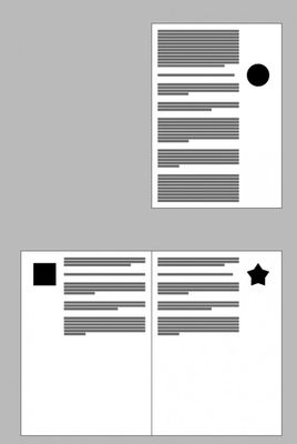

For instance - in a book with a side column for margins you can always have the image flow with the text and appear in the margin on the outside.
Making a few tweaks to this
You can then make this an Object Style
Now the image will flow and appear on the correct side of the page.
In the below layout using those settings the important shapes are on the foredge all the time.
Normally, if you reflow the pages, and this was to become a verso, then the circle would be at the spine! Which is not the layout required.
For example, if I wanted the text to flow back to the previous page, and the triangle to be on the left hand side, the anchored object settings allow this.
This gives very powerful layout options to ensure that the objects are always on the foredge and the text is always at the spine.
