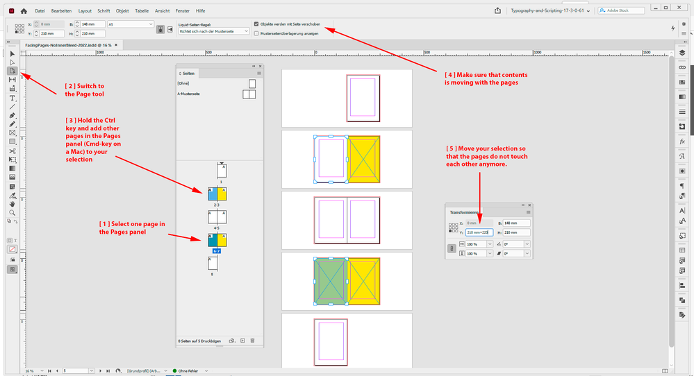

Hi @GalacticDad ,
here is a variant of a method I already posted a couple of times to similar discussions:
[1] Select one page in your document in the Pages panel
[2] Switch to the Page tool, that selected page will now be selected with the Page tool.
[3] Hold the Ctrl key to add other pages in the Pages panel (Cmd-key on a Mac) to your selection of the Page tool.
[4] Make sure that page contents is moving with the pages.
[5] Move your selection with the Transform panel up or down to an amount that the selected pages do not touch the opposite one of the spread anymore.
From my German InDesign:
The result should look like that:
Now you have the opportunity to add inner bleed to facing pages of your document:
Note: If you get an error message that the pasteboard area is not sufficient to hold the new position of the transformed pages you could add more vertical space to your pasteboard using InDesign's Preferences.
Preferences > Guides & Pasteboard > Pasteboard Options > Vertical Margins
Also note, that you may do this only to certain spreads where elements are close to the spine.
Before you begin, make sure that no elements cross the spine.
