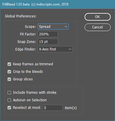

Mar 24, 2018 Mar 24, 2018
So I made a more advanced script.
New name: FillBleed. Supports CS4/CS5/CS6/CC and provides localization in EN (default), FR, DE, ES.
Here is how the UI of version 1.03 beta look like:
Download and test: http://indiscripts.com/blog/public/scripts/FillBleed.jsx
Note: This script is entirely based on IdExtenso's BasicScript module:
IdExtenso/$$.BasicScript.jsxlib at master · indiscripts/IdExtenso · GitHub
This was a perfect example for testing a real-world application of all its features 🙂
Marc
