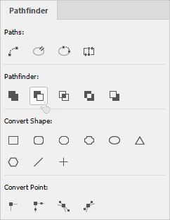

You do this using InDesign's Pathfinder panel tools, which are also located as sub-menu commands under the Object menu.
To make it easier to illustrate, the following screen captures use the panel tools:
1. Select your Red shapes using the Arrow/Selection tool and the Shift key. (Note: Do Not group them. While this is exactly the way you would make multiple "knockouts" with Adobe Illustrator, with InDesign grouping them will turn off the tool options. InDesign needs to read the stacking order to excise/knockout the shapes). Now select the Green background, as shown below:
2. Go to the Pathfinder panel, and click the Subtract button, as illustrated below:
3. End Result: you get the Red shapes "knocked out" of the Green screen above your plan illustration.
