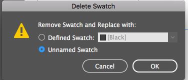

Hi All,
Is it possible to convert all the swatches to unnamed swatch?
var mySwatches = app.activeDocument.swatches;
for (s = mySwatches.length-1; s >= 4; s--) {
    mySwatches.remove();   //Need to change this line.
After that as per my request will invoke the All Unnamed Colors.
app.menuActions.itemByName("$ID/Add All Unnamed Colors").invoke();
Thanks in Advance

Have a look at the discussion in the following thread, it will lead you to a solution for your problem
Re: [JS] delete swatch without replacing
-Manan
Dec 28, 2018 Dec 28, 2018
While the link mentioned above will help you delete a swatch and replace with an unnamed swatch. What i want to understand is the end goal you are trying to achieve. I see you will
  • Delete swatches by replace it with unnmamed swatch
  • Then again add them using the "Add All Unnamed Colors"
So the end result will have the same no. of Swatches(in some cases) as the start, with the only change being that the swatches that could be deleted are renamed to their Color Values
Unless i am missing something why not straightaway rename the Swatch with the color names rather than going through the process of deleting and then adding.
In your case you might end up with some more swatches w.r.t. to some unnamed colors used in the document being added to Swatch panel. While in my proposed solution you would have the same number of Swatches before and after the process. If you want to add the unnamed colors used in the doc you can call the menu option once in my proposed solution as well.
-Manan

Hi Legends,
Thank you for your valuable feedback.
And sorry for the delayed response.
Request:
Find Hexa value for all swatches, for that am converting all swatches into RGB.
Problem faced:
If the swatches having the tint value, am not able to get the Hexa value.
For the tint swatch issue, am go through the below ways:
1. delete all swatches into unnamed swatch
2. Later, invoke the All Unnamed Colors
Below Code is developed so far,
1. Clean unused swatches
2. Convert all color to RGB
3. Invoke unnamed colors
4. RGB to Hexa value
5. TINT swatch (not able to find hexa value)

Jan 02, 2019 Jan 02, 2019
I don't have too much experience with colors and color conversions but i am still not clear about the workflow you are trying.
If the issue is getting Hex value of the color, i still don't understand the need to delete swatches and then adding unnamed colors to swatches. Can't this be done as follows
  • Convert all Swatches to RGB using something like the following code
for(var i = 0; i < app.activeDocument.swatches.length; i++)
     try{
          app.activeDocument.swatches.space = ColorSpace.RGB
     }catch(e){}
  • Now to obtain the hex value for each swatch, you already have the written the code in your sample.
  • For the issue with getting hex value for Swatches with tint, i don't think the hex value changes even after applying tint to a swatch(on InDesign UI i see that the RGB value does not change). Alternatively you could take out the new RGB values w.r.t the percentage of tint and then calculate the hex values.
Hope this helps
