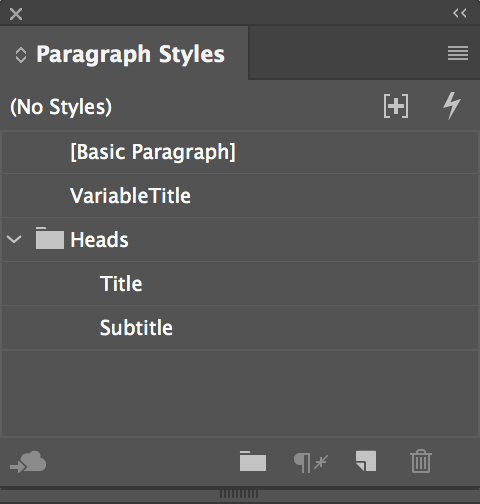

In either case, when you create a table of contents, you do so by specifying paragraph tags, which allows InDesign to then collect all of the content that is formatted with those paragraph tags. For example, one might tell InDesign to collect all content tagged with the paragraph tags called Title and Subtitle. You need to be consistent applying the same paragraph tags throughout a single document, and all the documents within the book window. The spelling of the tags must be consistent across book documents, and If you use folders to organize your styles, the folder names must be identical as well.
A particular source of angst is capitalization. If you tell InDesign to collect all the Titles and Subtitles in a folder called "Heads" (left) it will not find them in the folder called "heads" (right).

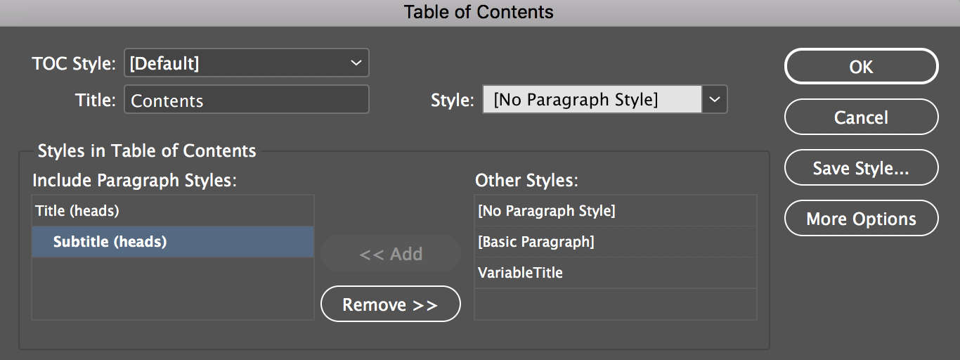

If you just have one file in the book, then I'd say just ignore the book and work with the one file. In that one file, here are the general steps:
  1. Determine what paragraph style(s) you want included in the TOC (i.e., Titles, Subtitles—the specific names don't matter)
  2. Review each page of the document—are all the titles tagged as Title? Are all the subtitles tagged as Subtitle? If not, assign the tags.
  3. Then add a page (or pages), if you don't already one (or more) for the TOC.
  4. Layout > Table of Contents. Define the Title (Contents or Table of Contents) and then select the paragraph tags and move them into the left column under the heading Include Paragraph Styles.
  5. Click OK and place the text on the blank page. Did InDesign find all of the text? If not, return to step 2 and assign the tags to the text that wasn't collected. Then repeat step 4.
