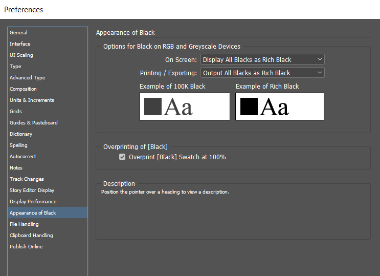

When you print what is the Print>Output>Color set to? If the printer is a composite RGB driven printer try setting your Appearance of Black>Printing preference to Output All Blacks as Rich Black and set the Output Color to Composite RGB

I have the InDesign file set to rich black, I will check the PDF and PS setting for the settings of rich black or composite RGB.

Check your preferences:
Appearance of Black
Aug 02, 2019 Aug 02, 2019
Sorry that was already suggested...

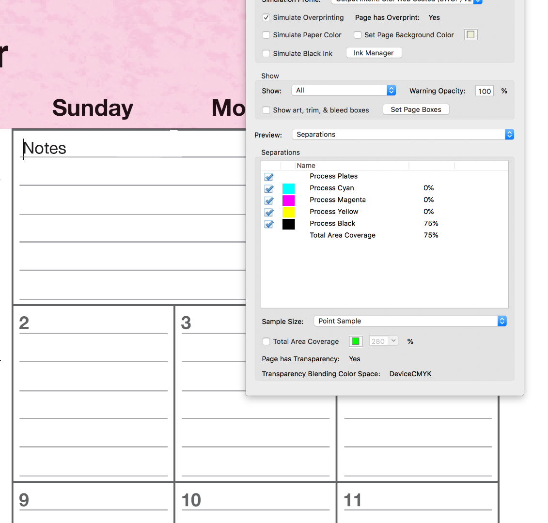

Community Beginner ,
Aug 05, 2019 Aug 05, 2019
Here is what I get by exporting to a  PDF/X-4 and if it still happens check Print As Image in Acrobat’s Print>Advanced
these are the settings on the Print>advanced box

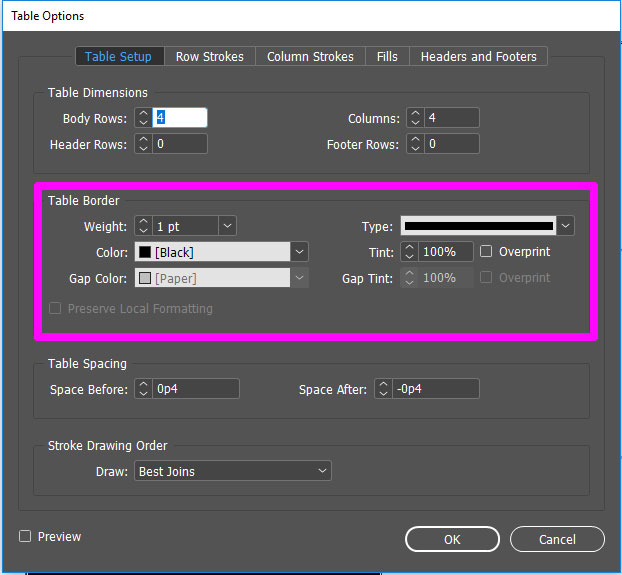

Can you select your table and then Table Options. Check your tint. It should be at 100% for table border as well as row and column strokes.
-Dax
Aug 01, 2019 Aug 01, 2019
Everything was set the same but, the color was blank, not black like what was in your pink highlighted box. I will check this out by printing it.
Right.. it might be blank for table border. But what about Row and Column strokes?
-Dax
